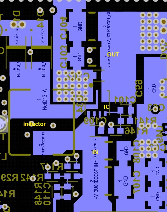

I am designing a board with TPS61022 and I would like to have your feedback on the layout, below:

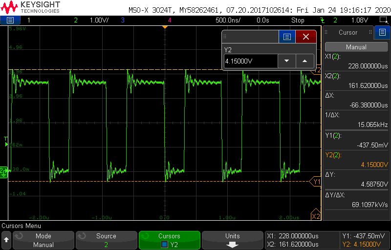

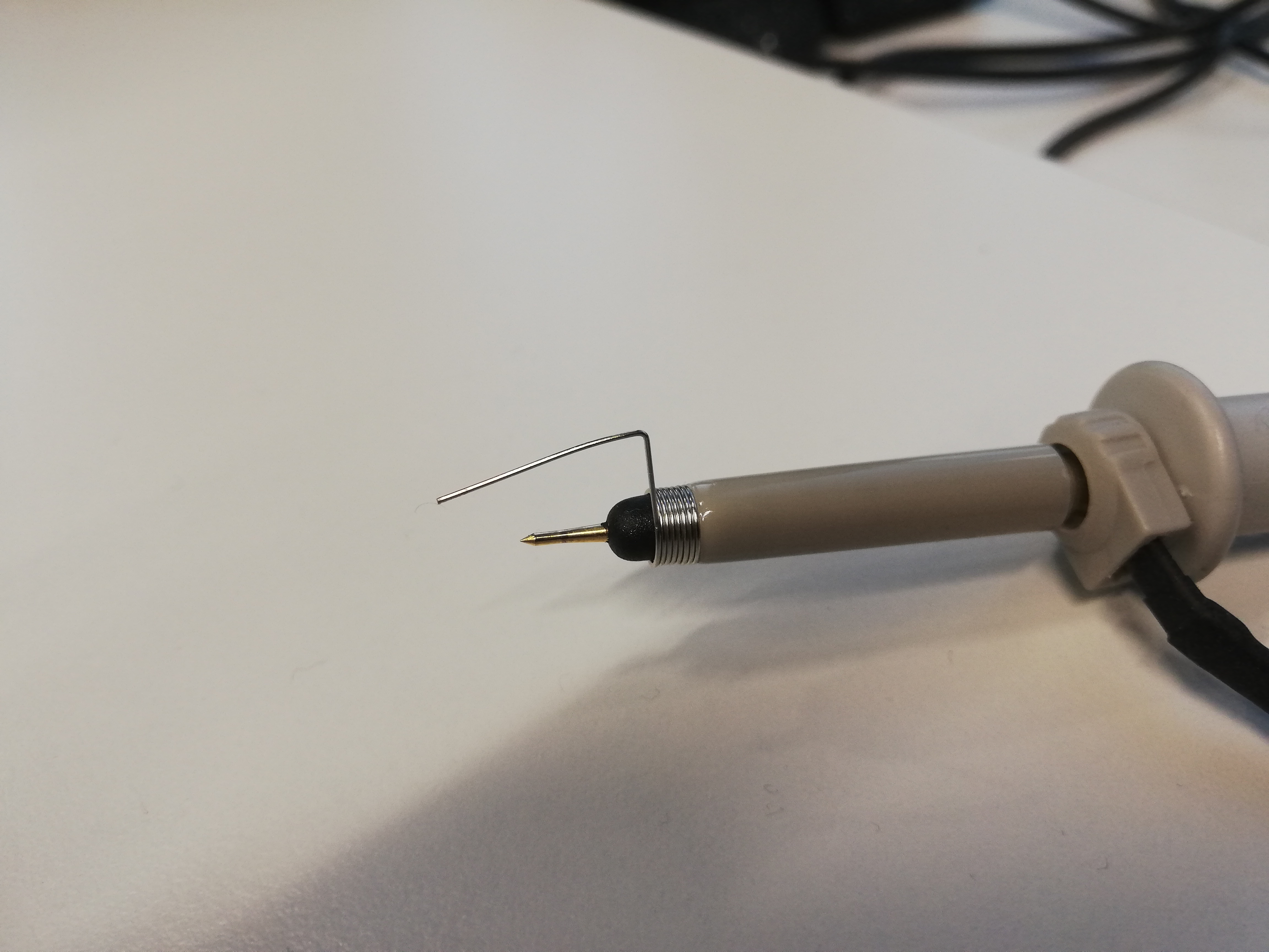

I measured also the ringing on the SW pin in the prototypes. Below the measurement...
Can you please confirm if this is ok? Thank you and kind regards
