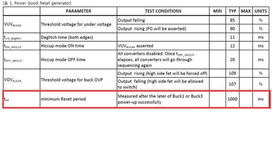

Q1) Why recommended to use pull-up resistor from the PGOD to the output of buck1 ?
     Another side effect buck 1,2,3 ?
Q2) Reset conditions?
 Datasheet conditions : Measured after the later of buck 1 or buck 3 power-up
successfully
I think buck 1,2,3 AND mod .  Im not understand .
