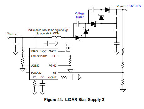

Hey Team,
Im looking to create a high voltage, high current supply to demo one of our current monitors. I saw this diagram in the LM5155 and I figure I can probably get around 250+ V output, but Im not sure if I can get 2A or more output.  Is this possible?  If so, do you have some TI design or app note that goes a little more in depth for the design of one of these?  I could supply the input with a 20V, 30A supply, or a 50V, 10A supply.  The 30A supply is a little less bulky and therefore I would prefer to use that one.

    Thanks for reaching out with your question.
    I would not  suggest using the LM5155 for 250V at 2A in this configuration. The output is is just a charge pump used to double the output voltage and is intended for small currents in the 10's of mA range.
    To meet the power requirements and step up ratio a two switch flyback might be the best choice.
    Please let me know if you have any questions. Feel free to contact me directly.
