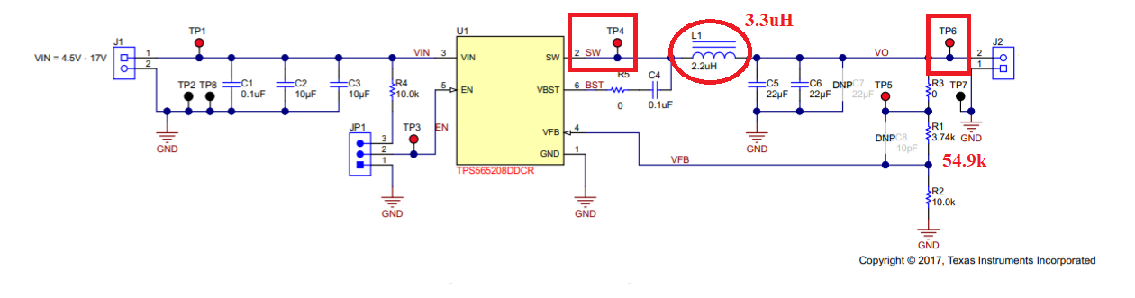

we have jumpwired the TPS65208EVM with one of our testmodules and noticed an audible noise around 16khz. The more load we add the louder the noise is. The load should be in the range of 0.5A-1.5A.

    TPS565208 is a FCCM device, and the switching frequency should be constant at around 500kHz at full range of load so that no 16kHz noises at the normal operation. Could you please check the output ripple waveforms to check if any low frequency ripple components?
    Also, could you please share me you schematic? What is the output and what is the output capacitance at output terminals?

    I can try to measure the ripple but the oscilloscope which I have access to is very old and has some junction issues as well (since I'm in Taiwan at the moment, not in our Lab in Europe and I have the device with me).
    We are using the TPS565208EVM (jumpwired the board) and changed R1 to 54.9K, so it's TI's reference design.

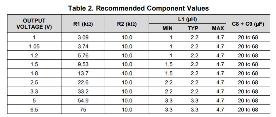

    Also please measure the SW node, to check the switching frequency is constant (around 500kHz) and no 16kHz components. Sorry that I am in Chinese new year holiday and have no idea which FAE in Taiwan you can visit.
    According to the recommendation table, I also recommend changing the inductor to 3.3uH/4.7uH.

  • Ok so we have found 4.7uH and implemented it in the TI EVB - as expected it did not solve the problem. The audible noise is still the same.
