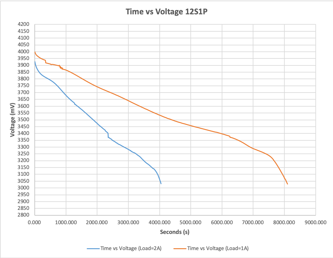

BQ78350-R1: "Accuracy Error: Deviation is so high" problem with the uploaded GPC files
Part Number: BQ78350-R1
I have a problem with my uploaded GPC files. I think the termination voltage is ok, and everything else.
I suspect that the problem can be that I did not do against high and low temperature just room and copied the same data
to high and low temperatures?
Could you check my data?
