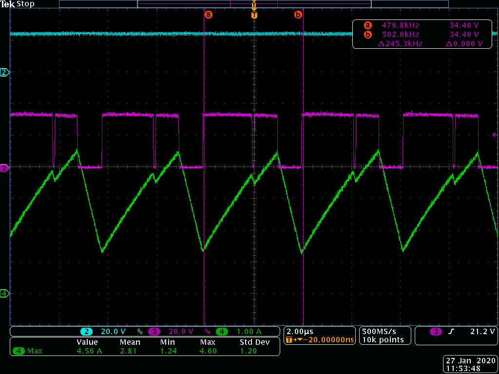

Increasing the output current will lower the switching frequency.
(When Output current exceeds 0.7A over,switching frequency is lower.500kHz⇒250kHz.)
(Waveform①)
Iout:0.6A
Ch2:Output voltage
Ch3:Switching voltage
Ch4:Inductor current

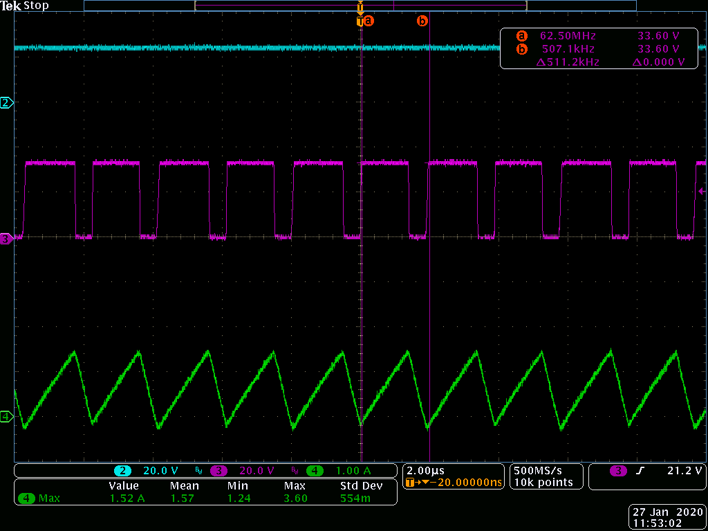

(Waveform②)
Iout:3A
Ch2:Output voltage
(Question)
Q1
Is this behavior normal?
Q2
Why does the switching frequency drop?
