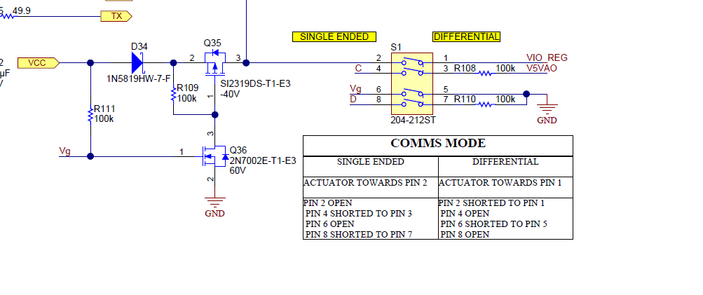

  • Hi Malli,
    Can you confirm that you have the switches below set correctly for single-ended?
    Vince

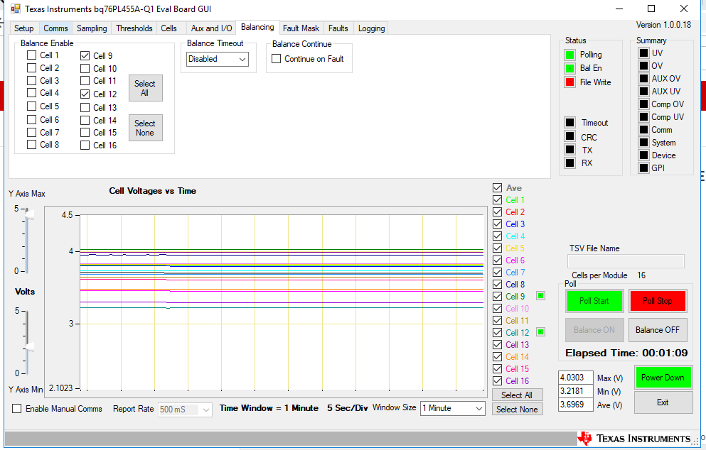

  • Hi Vince and Taylor,
    Thanks for your support.
    I am able to resolve the above FTDI Drivers issue.
    But i am facing other issue.
    In GUI, It is showing balancing is happening, but actually my all cell voltages are same for infinite time.
    I tried to change  the EMB_Vset value with different values from 0 to 10 but no use.
    kindly suggest.
    Malli

  • Hi Roger,
    My cells are Cylindrical cells and around 2.6 Ah.
    I am using the software code as it is(downloaded from TI website(TMS570BMS). i did not change a single word in the code. just i changed the EMB_Vset(0,2) to EMB_Vset (0,5) with different variants.
    My GUI showing Active Cell Balance is Active i mean showing the green colour beside the cells which are choosen for Active balancing.
    I am  attaching Screen shot here,
  • Hi
    I haven given only one minute data.
    but it is happening even for 2-3 hours.
    and i checked VIO, DAC out put, VP
    these values are showing VIO=3.3V , VP=5V, and DAC out put=1.28V
    NOTE: Tell me if i want to change anything in code and where to change and  why?
    Waiting for your valuable suggestion
    Malli.
  • Hi Malli,
    Can you please clarify what you mean by "In GUI, it is showing balancing is happening"?
    The GUI can only be used to monitor the cell voltages. The balancing functions in the GUI cannot be used to control the active cell balancing devices (EMB1428/EMB1499). You need the microcontroller to do that.

  • Hi Leslie,
    I am using microcontroller also.
    In Gui, there a BALANCE tab, from there I clicked cells balance. It is showing green color , but actually no current is flowing in the hardware.

  • Hi Malli,
    Would you be able to change the above value (EMB_Vset) back to the default as well, so that it is 1-to-1 identical to the original sample code? I believe modifying this may cause issues with the current sample code.

  • HI Malli,
    I saw this on one of your previous posts:
    "In Gui, there a BALANCE tab, from there I clicked cells balance. It is showing green color , but actually no current is flowing in the hardware."
    Just to be clear: the BALANCE tab in the GUI does not control the active cell balance devices (EMB1428 and EMB1499). That tab is to control the passive cell balancing on the BQ76PL455A device which you are not using. If you are enabling cell balancing from that tab you won't see balancing on the active cell balancing devices. Please use the GUI only to monitor the cells. All actions and commands to the EMB devices come from the microcontroller.
    I suggest you check the response from the EMB1428 device to the MCU when you send commands (through SPI). You should get information on what error is happening to know if the switches are closing and if the EMB1499 is charging/discharging.
