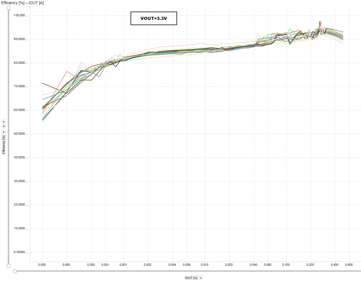

The customer is considering TPS63001.
Among them, efficiency information is a major criterion.
Do you have efficiency data with the following conditions?
・Vin⁼2.7V to 4.5V
・Vout=3.3V
・Iout=10uA to 0.5A
