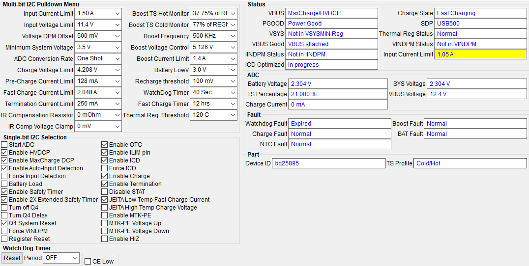

  • Jeff,
    I'm charging a half charged battery and also adding extra load with some LM317s on a heatsink configured for constant current mode.  I see no increase in input current when I add additional load.  Below are the registers:

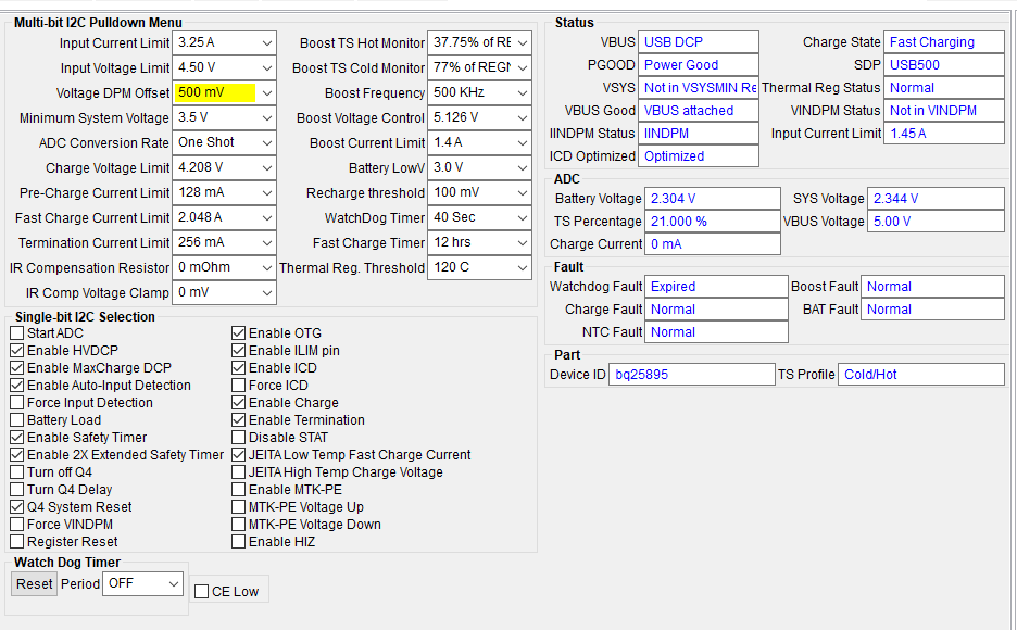

  • Below are your settings at 12V
    and 5V:
     In both cases, relative VINDPM and ICO/ICD are enabled.  Even though in the 12V HVDCP case, IINDPM reg is set to 1.5A, the ICO/ICD routine determined that the input power source or connector or cable is too resistive, causing the voltage at VBUS to droop below the VINDPM value of 11.4V. The ICO/ICD routine has limited the input current to 1.05A. But, there is still enough input power for your SYS load plus charge current because none of the DPM loops are active.  However, for the 5V DCP adapter, IINDPM is at 3.25A but ICO/ICD  has limited the input current to 1.45A and the charger's IINDPM loop is active when means there is not enough input power for the system load plus charge current and charge current is reduced.  If you can't make your input source+connector+cable less resistive, you can change to absolute VINDPM using the force VINDPM and lower the VINDPM threshold and/or you can disable ICO/ICD.
    Jeff

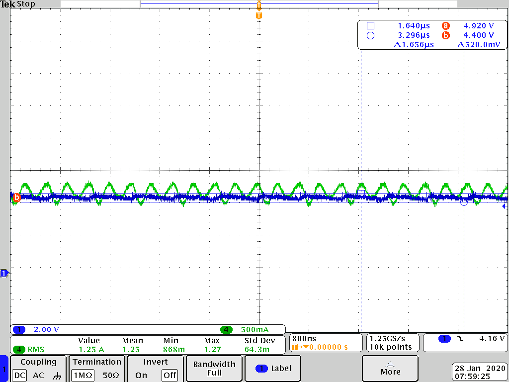

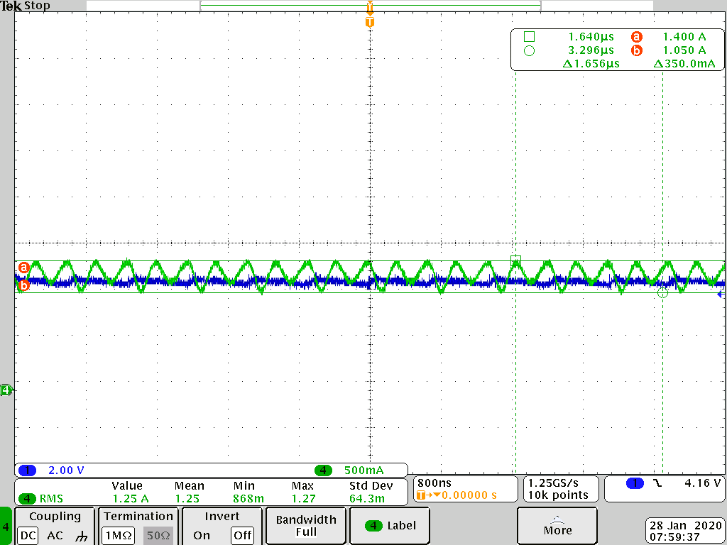

  • Jeff,

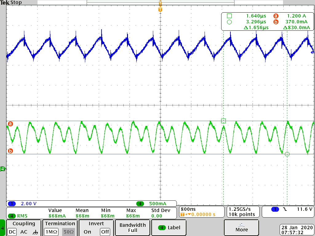

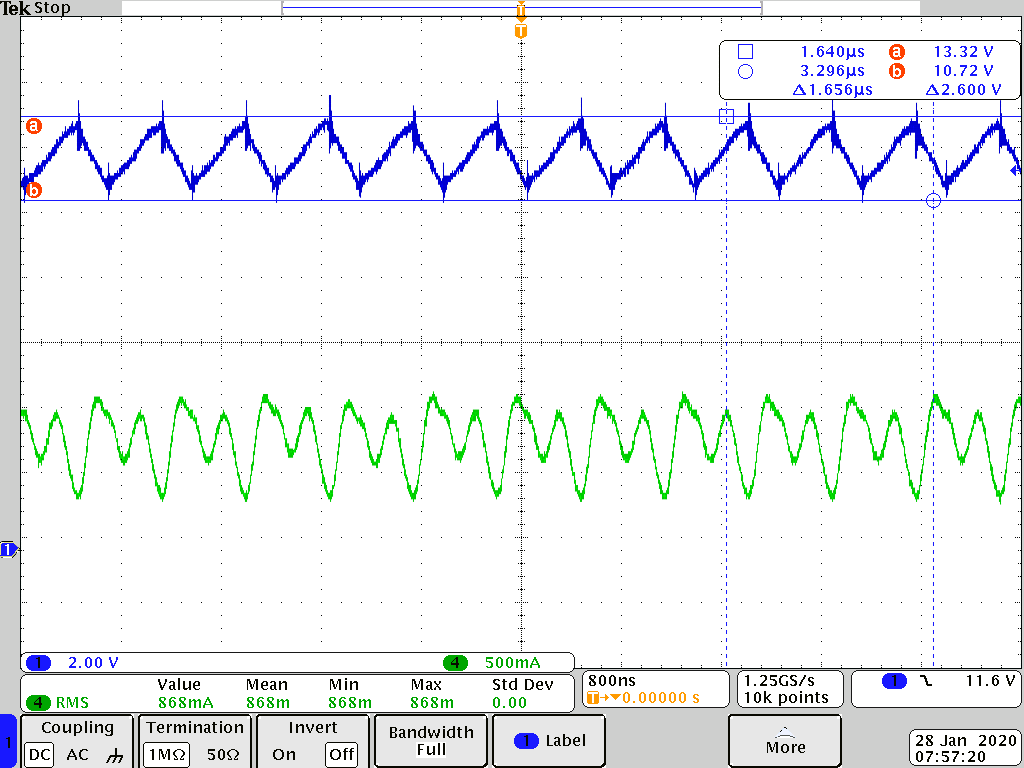

    I went back and changed the max fast charge current back to 2.048A.  Below are the scope shots of a 12V QC3.0 Adapter and a 5V 2.4A adapter.  Yellow is Vsys and Green is the current on Vsys.  The system is of so all the current is going to the battery.
    12V QC3.0
    5V, 2.4A Adapter
    The input ripple is pretty bad with the QC3.0 adapter.  I'm assuming this is because we are limited to 1.0uF of input capacitance.  It seems like an a lot, any DC-DC I've designed has always had much less.
    I'll go back and capture the same with the charge current set to 5amps.  I'm a bit concerned that it was overloading the 12V adapter, the adapter is rated for 18W and it was drawing 25watts.  It should have limited to 1.5A regardless, but I did not see this behavior and the BQ25895 got very hot under these conditions and it appeared to go into thermal shutdown.

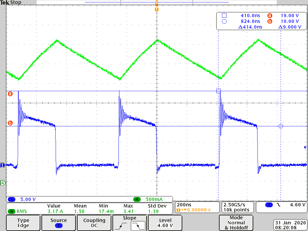

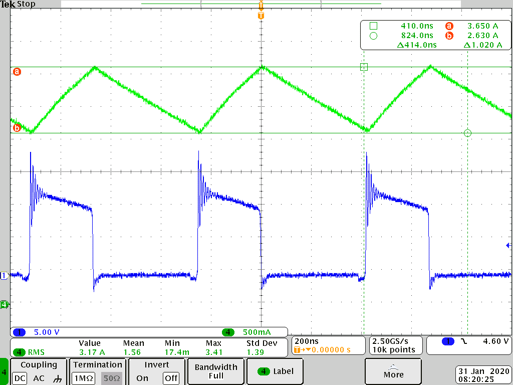

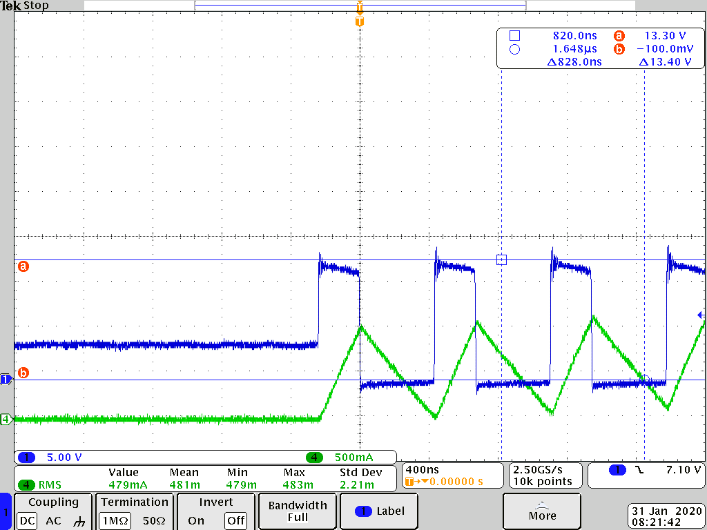

    Here are some pictures of the inductor current while it is charging with a 3Amp limit.  Blue is the switch node and green is inductor current.  It still does this weird shutdown where it stops charging for 30 seconds and then charges for a few minutes and turns back off for 30 seconds.  I'm watching the IC temperature and it is only getting to 65-70C according to the thermal imager.
    This is what it looks like when it stops charging for 30 seconds
  • Andrew,
    The SW node waveform has a steep slope which implies high resistance somewhere.  Are the register values that your previously provided from the period when the charger is operating correctly or when it is not charging?  I need to see the registers when it is charging and not charging including the ADC measurements.  Also, can you provide scope shot of VBUS, IBUS or IL, VBAT and IBAT and also VBUS, IBUSor IL, VSYS and ISYS that shows the when the charger stops and starts switching?
    Jeff

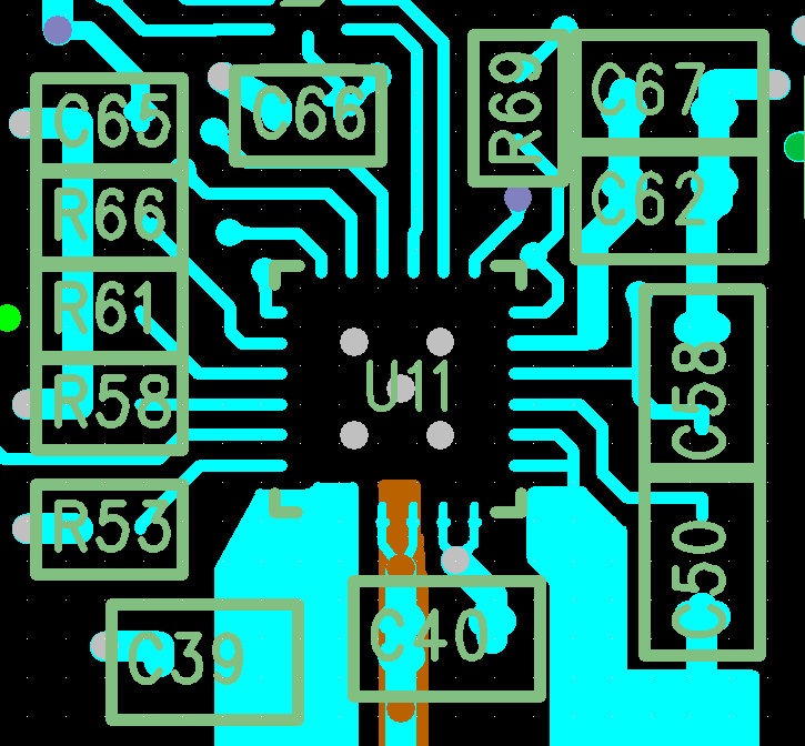

  • Andrew,
    That seems indicate that your board has a grounding issue.  How are the IC powerpad and PGND pins connected?
    Jeff
  • Pads are turned off so you could see the vias.  There are two internal layers that are just ground plane.
