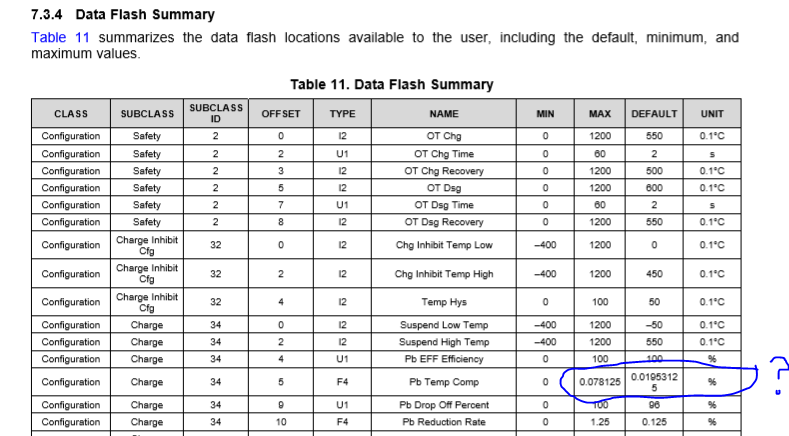

I am optimizing a design for a lead acid battery using the BQ34Z100-G1 component.
I have a few questions.
1) What should I set  the value for "Pb Tem Comp"  and what effect does it have? I found misleading information in the SLUSBZ5B specification.
in the Data Flash Summary table 11, it indicates a very small value in percentage. The default is shown to be 0.01953125 % ??
However, in the section 8.2.3.1 Battery Chemistry Charge Termination , Table 25 it indicates the number should be 25%.
2) Likewise, can you tell me what value I should use for Pb Reduction Rate and what effect does that have?
