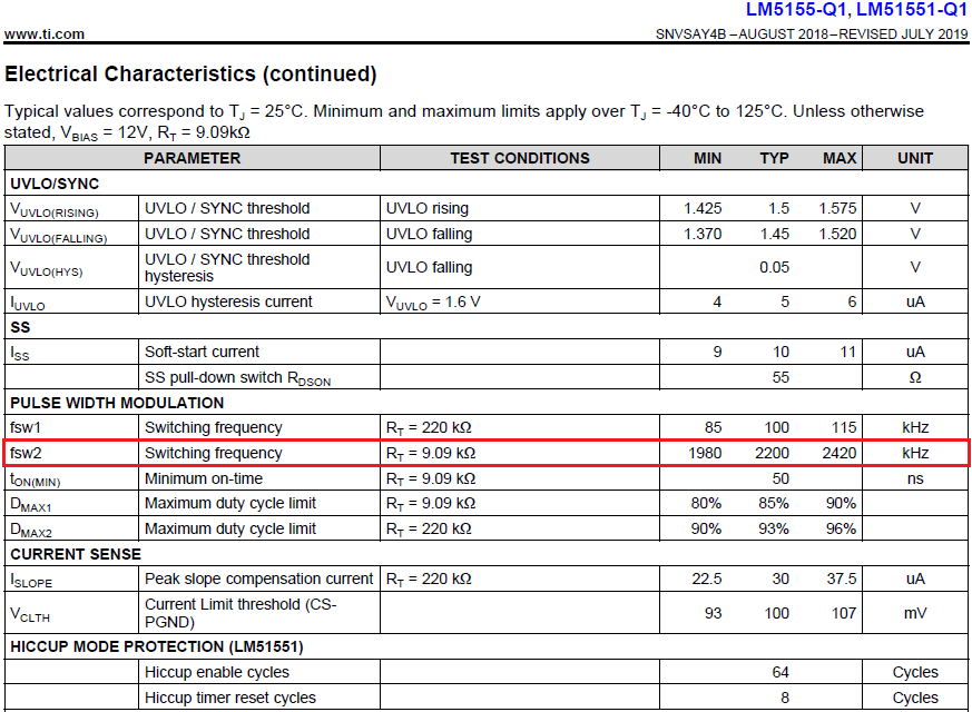

Hello Power team,
My custoemr asked about the switching tolerance of LM51551-Q1.
According to the datasheet, the fsw spec is 1980kHz(min)/ 2200kHz(typ)/ 2420kHz(Max) as capture below.
But my customer want know about the accuray of the switching tolerance of LM51551-Q1 itself (or internal oscillator variation spec) when setting the fsw=2200kHz using Rt=9.09kohm+/-0.1% resistor tolerance.

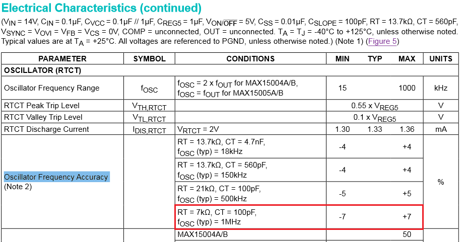

  • Hi Youhao,
    Thanks for your response.
    My customer wanted to know the intenal oscillator frequency accuracy of LM51551-Q1 itself excluding external RT resistor. Because the MAX15005 has +/-7% tolerance @ Fosc=1MHz as capture below. So please check the intenal oscillator frequency accuracy of LM51551-Q1 for Fsw=1MHz and 2.2MHz, respectively.

  • Hi DY,
    The frequency accuracy at 2.2MHz is already given in the datasheet, it is 1980 to 2420 KHz.  In other words, it is +/-10% about 2.2MHz.  At 100kHz, it is +/- 15%. I don't have the char data but it should be close to +/- 12.5%.  Note that these are datasheet parameter limits.  Actual device frequency tolerance would be much tighter but the datasheet just gives out the worst case parameter spans and you should not easily see such extreme numbers in real circuit.
