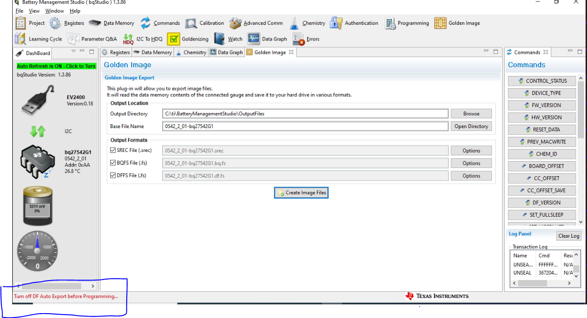

Hi team ,
We have done with learning cycle and moving forward to create golden image.
While creating golden image we are getting one error and attaching the snapshot .
Please let me know what to do and How ?
Please consider this is an urgent !!
Please do needful
  • Disable Auto Export in the Data Memory Window and try gain.
  • Hi Andy,
    How can we disable ?
    I tried but not able to disable
    Please help here .
    Vishal
  • The easiest way is to close the Data Memory Window.

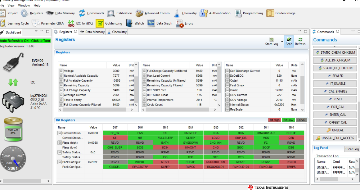

  • Hi Team,
    We ran the ChemID process on one more Setup and we were getting the ChemID 2076 with deviation is 5%.
    We are running the learning cycle again with this chemID.
    On the first discharge cycle, our RUP_DIS bit is high and the Vok bit is low which is not expected?
    Do we need to start the Discharge cycle and once gauge has the OCV reading then automatic transition happens for RUP_DIS and Vok?
    Can you please suggest ASAP?
    Saumil
  • I am attaching the snapshot here :
    Initial discharge
    Let us know we are going right ?
    Now update status is 04.
    Please do needful.
  • First of all, a 5% deviation is a bit high. Usually a 3% deviation is acceptable.

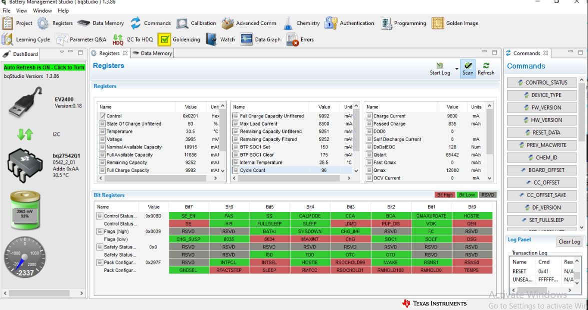

  • Hi Andy,
    We started with the another learning cycle for the fuel gauge. After Initial Discharge and relax, we are observing that, during the first charging of the battery VOK bit is not getting set and RUP_DIS bit is not cleared in the charging cycle. Please find attached screenshots for this. Please let us know on this anamoly ASAP .
    Mahek Delawala
  • Hi Andy,
    I need to add one more point in this charging cycle. When the battery is charging and it reached around 95 % , after sometime suddenly SLEEP bit was set and RUP_DIS bit was cleared, VOK bit is still low. Now it is taking zero current. Does this behaviour expected during the first charging cycle stage of Learning Cycle Process ? PFA screenshot for this. Let me know if you need more information.
    Mahek Delawala
  • Hi andy,
    In Learning cycle following bits are not set :
    FC  and VOK bit in charging cycle.
    Update status is not moved further. Its 04 only even after second relax cycle.
    I am attaching auto exported logs and let me know your input on this.
    We will work on your time  and  I am requesting you to discuss over call.
    Please understand the urgency.
    Please do the needful. Auto_export.zip
