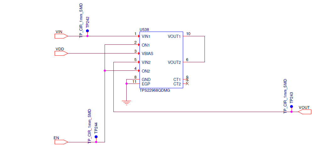

I'm experiencing something I didn't expect using this switch. I'm using it in reverse current protection configuration.
My EN signal is 3.3V and my bias voltage is 4.5V.
If I close the switch, but I don't have anything connected to the VIN (disconnected the power supply), I still measure close to 3V on the output???
This makes me a bit concerned for leakage of some kind.
Any ideas?
Best regards
Jon Eirik Sternang

    Quick question regarding your schematic- in the situation that you are seeing a leakage on the output is a load connected? If that load is connected does it have some under-voltage logic that would disconnect it in this case? The theory here is that a floating load would potentially cause leftover capacitance and account for that leakage that you are seeing.
    Also in the situation where you see the leakage do you have the the supply turned on and then disconnect it while the ENABLE is high or is this state from a cold start up? A few scope shots of the test points you have on your schematic would be helpful to diagnose here: Enabling/Disabling the power switch both with the supply connected/disconnected.

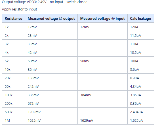

    During these measurements my load is not connected, only a voltage follower to monitor the voltage, and a multi-meter.
    To get an indication of the strength of the leakage, i measured the leakage voltage vs load resistance.
    As you can see I measure the same voltage on both input and output. The voltage is static even when using a load, so it's not simply a charge on a capacitance.
    We are using the device variant with discharge mechanism. Our power up sequence is always to apply VBIAS before we turn the switch on.

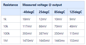

  • I've tried to check this across temperature.
    Up to 85 degC, the leakage is 'fairly' constant, but at 125 degC it seems to drop significantly.
    I also tried to mount the variant without the discharge, but still see the same issue.

    In this case the load is high impedance (voltage follower and multimeter configured to measure voltage). From what I have seen the it doesn't matter if I put the resistors on the input or the output of the switch, there seems to be some leakage going through the resistors anyways.
    This is how I tested:
    1. No source connected to Vin
    2. Set switch on with no load
    3. Measure voltage on vout (might be in the range of approx 2.5V)
    4. Apply resistance on Vin or Vout
    5. Measure voltage
    6. Vary resistance and measure voltage again.
    Notice that we are using the reverse current protection configuration. I also tried to replace the part with the variant without discharge, but it gave similar results.
    Best regards
    Jon Eirik

    We don't have a spec for this leakage because the conditions you mention are outside of our recommended operating conditions. Our minimum recommended VIN voltage is 0.6V, and by leaving the input/output voltages floating, the device is not being operated in the conditions under the datasheet electrical table. The leakage present here would be coming from the VBIAS pin, but we haven't characterized the case where VBIAS is present, ON is high, and VIN is not applied.
    The one spec that would help to understand the max possible leakage of the device would be the quiescent current from VBIAS since that would be the source of the leakage present on the input/output. The leakage to input/output would get worse with hotter temperatures, so if you are looking to see the max expected leakage from the device, that would be the way to do it.
