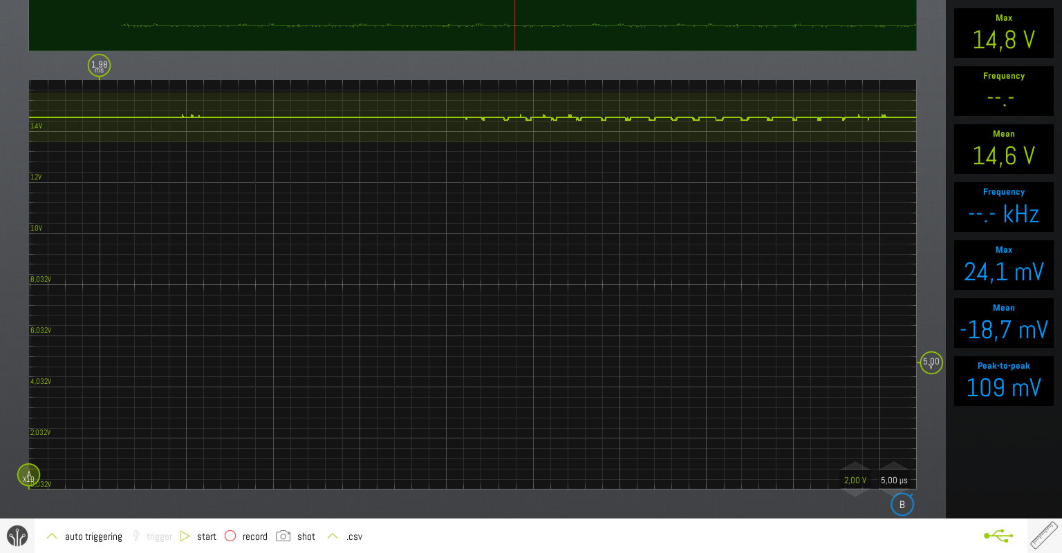

The system is working, but Ive got a very annoying noise coming from the power management stage, and I think that I found the source of this noise, which must probably be the inductor. This is the waveform on SW:

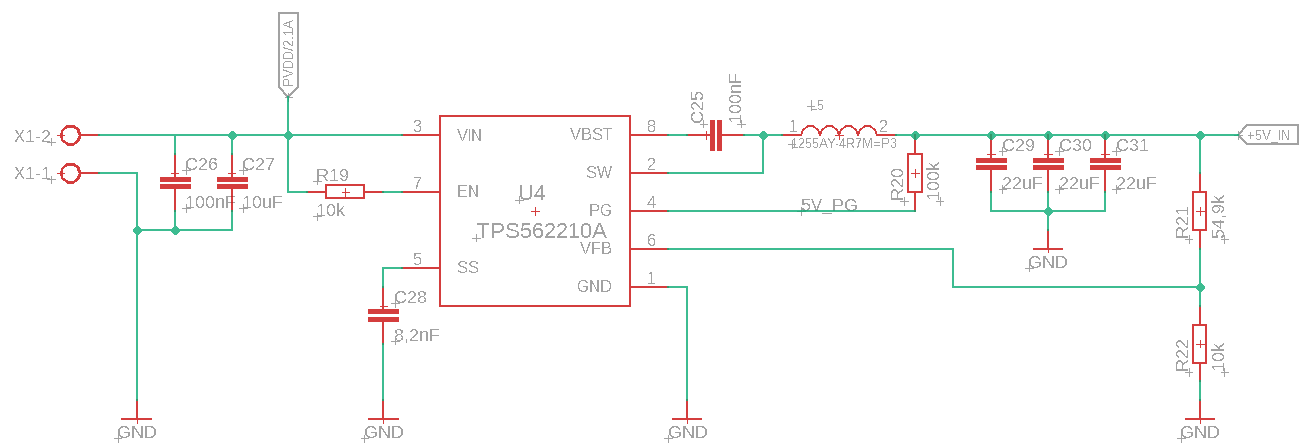

The problem is that I don't know what is causing this issue, as I followed the guidances from the datasheet and the EVM User Guide. Any advice on this will be more than helpfull!
Attached are the schematic and the layout of the circuit.

  • hi Yoann,
    Checked the schematic and it is ok for me.
    Need more information to analysis:
    1. Loading is stable or dynamic? if it is a stable loading, what value?
    2. plot Vin, Vou(AC, check ripple)

    2. Here are the two plots you asked for (Vin first, and Vout)

    Because the load changes, so the switching frequency is lower when the converter enters Eco-mode, when the frequency is below 20KHz, or the difference frequency interference is caused by the audio IC working frequency and TPS562210A switching frequency.
    From the layout, we don't recommend put the SW trace under IC, the switching noise is easy to be introduced to FB pin, this may lead to the unstable.

  • Ho Shawn,
    Thanks for the precision, I did change the position of the SW trace following the PCB layout recommendation, but didn't try the new layout with TPS562210A, just with TPS562219A, so can't say if it was the only problem. I'm just happy of not hearing this noise anymore!
