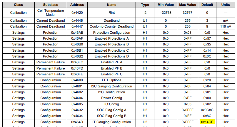

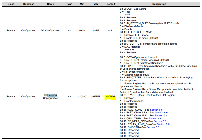

The TRM gives two different values for the default of IT Gauging Configuration:
Which is correct?
Michael
