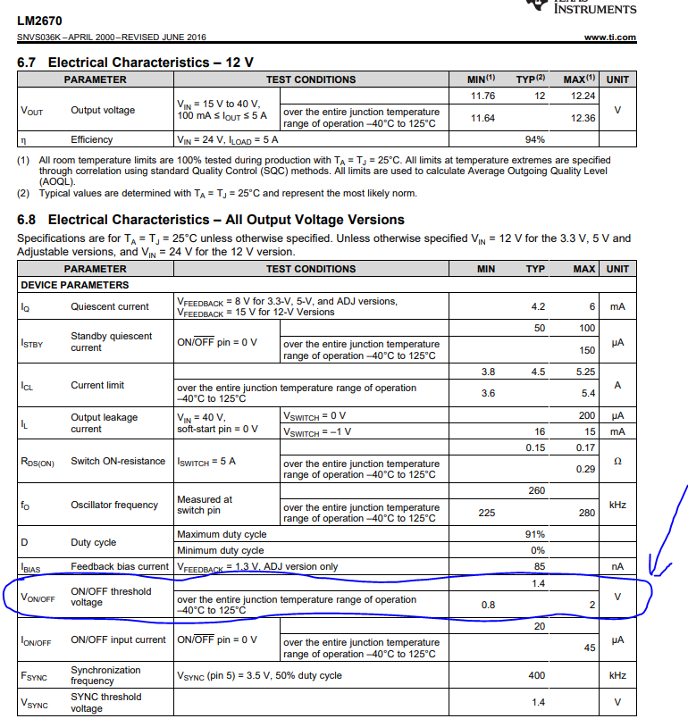

I am using the LM2670X-ADJ IC in a buck boost configuration successfully.  The schematic is attached below for you.  I need to be able to enable and disable this IC.  How can I do this?
The datasheet excerpt is also given below. It shows that the ON/OFF pin can be set to 0.8V to 2V to turn the device ON.  Likewise a voltage between GND and 0.8V will turn the device OFF.
Can you advise what voltages do I need to set the ON/OFF pin to enable or disable my Inverting Buck Boost?  The current implementation has this pin floating (Pin 7).  What levels can I apply to Pin 7 to enable and disable the part?
The section of the D/S is given below:

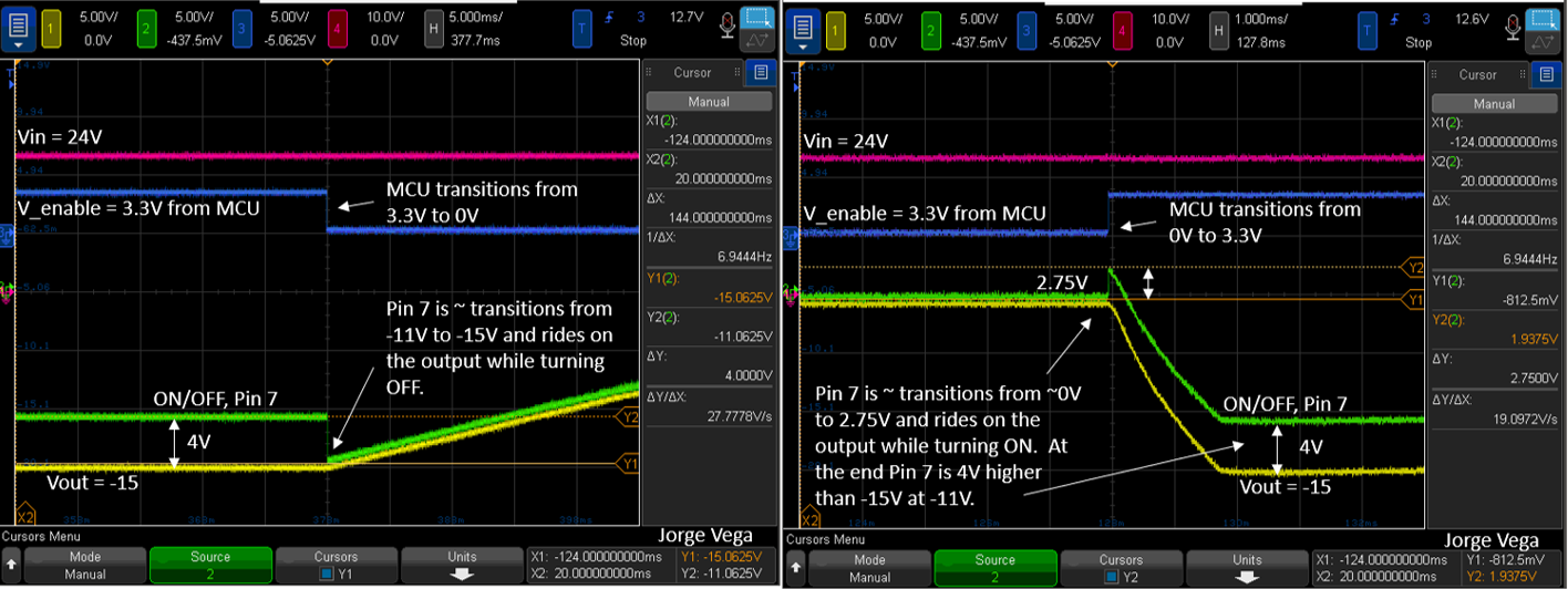

    I was able to use a modified version of the level shifter ckt on Frank De Stasi's app note to successfully enable and disable LM2670 (figure 9).
    The key to doing this lies in the fact the ON/OFF pin 7 cannot see higher than 6V relative to -15V otherwise the part breaks down when turning ON. This is actually in the D/S page 11 on section 7.3.7.
    So for this application pin 7 needs to have anywhere from -15 to -14.2 relative to -15 to turn OFF (in other words about 800mV from the most negative voltage).  To turn ON, the device needs to see a voltage between -12V and -9V relative to -15 (6V from the most negative voltage MAX).

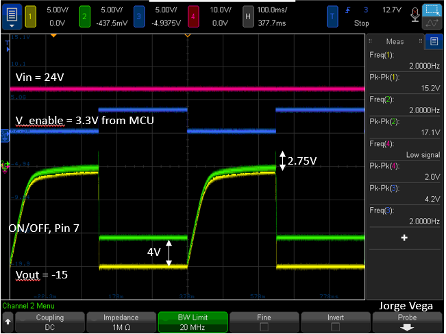

    I worked around these values such that in my application I turn LM2670 OFF when I apply the most negative voltage to pin 7. Conversely to turn the device ON when I apply 2.75V above the most negative voltage.
    So if the device is ON and regulating, I apply -15V relative to the output which is -15V to turn it OFF.  If wish to turn ON I then apply a divided down voltage that results in about  2.75V relative zero volts to turn it ON (in this case the output of the regulator is OFF and at zero volts), in the end bc I use a divider this voltage grows to 4V which is lower than the 6V limit shown on the D/S.
    The scope shots show the detail while the circuit shows the level shifter I used.  Care needs to be given such that the gate of the FETS can withstand +24V and -15V swings. To this end I chose a PMOS from DIODES INC, DMP510DL-7 that can withstand +/-30V at the gate.  Both FETS need to withstand from 24V to 39V BVDSS.  The FETS I chose have BVDSS rating of 50V PMOS and 60V NMOS.  The Resistor ratio I used is 80K to 10K.
