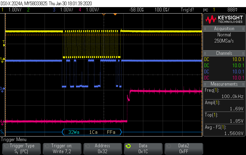

Dear Team,
I am using LP55231 for turning on and off LEDs.I observed that it is turning on RED Led only not the other two.
For RED LED it is toggling properly.Please find the attached Scope Image .For Blue and Green it is not at all toggling.
I am getting Vout(PIN NO=22) always zero.What is the expected value at Vout
Also please see the I2C Script I used
Please find my attached Schematic.
Hari
