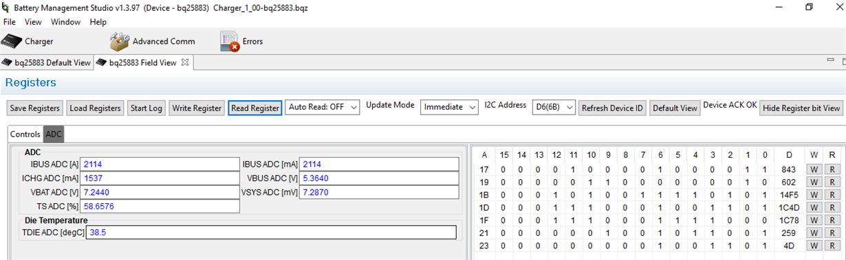

Hello, I use the BQ25883 to charger 2 NCR18650GA battery Sanyo (2s configuration).
I use Battery Management Studio to know all register values and parameters.
I have connected a ammetter to measure charger current towards battery.
Trickle Charge and Pre-charge step run right.
But when Fast-Charge CC step start the ICHG ADC charger current on BqStudio is quite differet from what I read by my ammetter.
Furthermore, I see that in this step, current isn't costant as must been in Fast-Charge CC; it seems to be pulsed and it decrease slowly. Moreover, I have used a DC Power Supply that can provide up to 5A, but despite the ICO limit is setted at 3000 mA and Fast Charge Current Limit at 2000mA, the current never reached the set thresholds.
I have pull ILIM pin to ground with 383 ohm resistor to set about 3A input current limit.
Where is the problem?
Thank you!

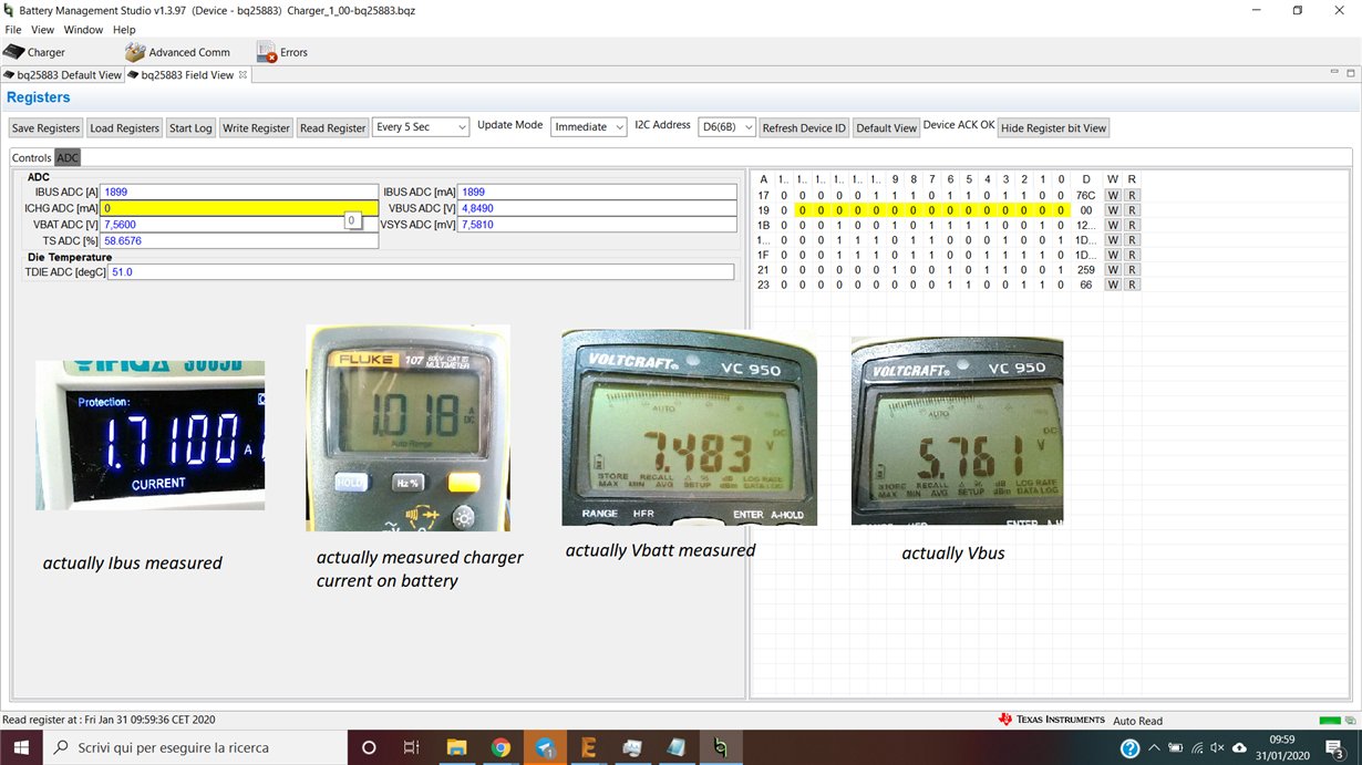

  • Hi Jeff,
    as you suggested me I have measured several parameters.
    Below pictures show voltage and current on battery and power supply.
    As you can see there is a proble with ICHG ADC measurements.
    I wait a response.
    Thank you for support.
  • Fabio,
    Is you ammeter in series between BAT pin and battery?  If so, can you remove it.  The ammeter adds resistance and also the autorange feature can cause issues.  After removing the ammeter, what are the results?
    Jeff
  • Hi Jeff,
    I have removed the ammeter but it doesn't change nothing.
    What can I try other?
    Fabio
  • Fabio,
    I tested an EVM and got the correct results, shown below, so it doesn't appear to be a BQStudio problem.  Does this happen on multiple boards/ICs or only 1?  If only 1, can you give me the top marking of the IC?

  • Hi Fabio,
    As I recall, my input current limit was set to 2A so my charge current is power limited.  Even at IINDPM=ICO=3.3A, the IC is power limited at high battery voltage as shown in datasheet figures 1 and 2 page 13.

  • Hi Fabio,
    I tested another BQ25883 and it works as well.  Just to clarify, the IBAT ADC only reports current flowing from SYS to BAT (i.e. charging current) not current from BAT to SYS (discharge current for HiZ, supplement or OTG mode).  Your registers do not show that the charger is in any of those states, the IBAT ADC is not disabled so I would expect IBAT ADC channel to function.  Do you have another IC from a different lot that you can replace on the EVM board and test?
    Jeff
  • Hi Jeff,
    When you say "...reports current flowing from SYS to BAT" do you mean from VBUS to VBAT?
    About IBAT ADC, sometime it reads right value. It isn't always zero.
    I have already try to replace the IC, but are all of the same lot.
    I have seen the figure 1 and 2, but I don't understand the maximum current charge and efficiency relationship. Cannot reach 2 A charge current?
    Thank you!
    Fabio
  • Hi Fabio,
    The IBAT ADC channel can only report current flowing from SYS output of the boost charger to the BAT pin.  It cannot report battery discharge current (so called negative current) flowing in the opposite direction such as when the charger is in OTG buck mode or in supplement mode (providing current to SYS load).
    Regarding efficiency, all dc/dc converters have a maximum output power for their input power.  It is most easily estimated using an efficiency power balance where eff = Pout/Pin=(VSYS*ISYS+(VSYS-VBAT)*IBAT) / VBUS*IBUS.  The input power is either limited by the input power source, the charger's input current limit (IINDPM) or VINDPM or the charger's internal FET cycle-by-cycle current limit.   If you have no SYS  load, are in input current limit and the V(BAT)>MINSY, the equation simplifies to eff=VBAT*IBAT/VBUS*IINDPM.  Even at unreachable 100% eff for VBAT=8V, IINDPM=3.3A and VBUS=5V, IBAT = 2.06A.  When you add in losses (eff<100%), the maximum output current decreases. If you increase VBUS to 6V, you can almost reach 2A charge current.
    Jeff
