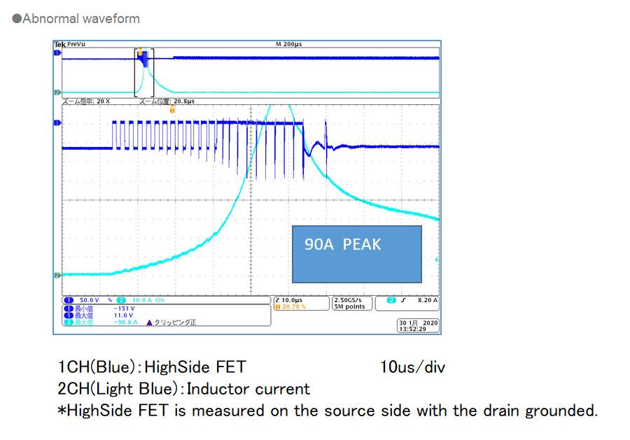

I have a question about a LM5116 from a customer.
Attach the startup waveform of PDF file.
The set oscillation frequency is 100kHz, but it operates at around 500kHz in case of abnormality.
In addition, at the time of abnormality, an excessive current that the inductor current exceeds 90 A flows because the ON width is expanded from the middle.
The effect destroys the LM5116 and the FET.
This phenomenon rarely occurs in an environment of 25°C., but frequently occurs at high temperatures.
Could you tell me why the abnormal behavior happens?
Is there any way to improve abnormal operation?

  • Thank you for your reply.
    My customers design on WEBENCH and check their behavior in advance with EVM.
    My customers are asking for information on whether this behavior at startup is a bug in the device or whether it can be improved by changing the constants.
  • additional information.
    My customer also measured the phase margin but it was 60 degrees, so I think the stability of the feedback loop is fine.
    The waveform at the time of abnormality is shown below. Are there any conditions that change the set frequency?
    Also, in the overcurrent state, the on-period is lengthened and the current is going to flow further, so this seems to be performing positive feedback.
    If you need a schematic, I can send it to you personally.
  • Hi Kaji,
    Please upload the schematic and layout for review. In particular, the DEMB pin sets the operation during a pre-bias startup. The voltage is sensed at SW and the trace from SW at the MOSFETs to the controller should be short and direct.
