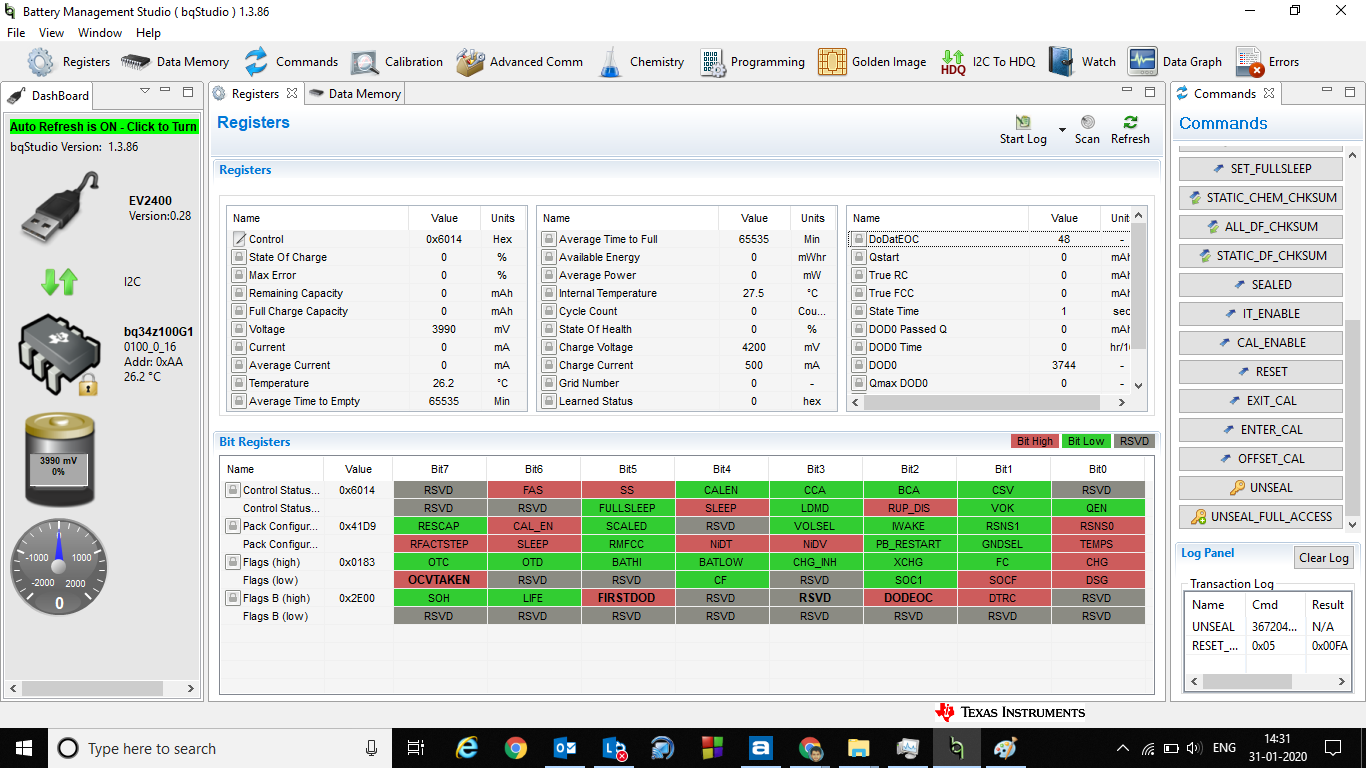

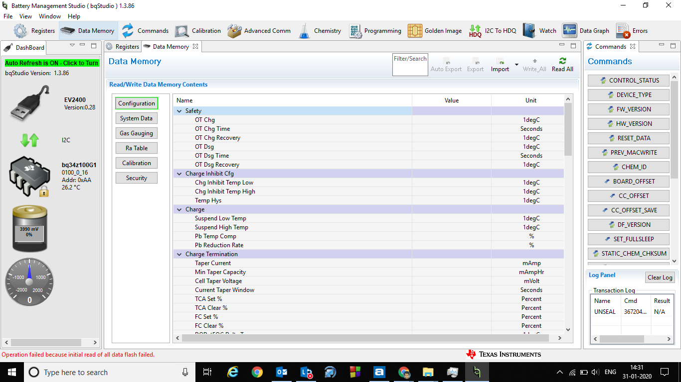

1. IC is not allowing to access the dataflash memory. Even after sending the command of clearing SS flag of control status register. This flag automatically gets set on next instant making it back to seal mode.
2. IC parameters such as SOC, SOH, MaxError, are zero always. However, it is  communicating the voltage and temperature correctly.
3. On the BQ's TI application(Battery Management Studio .exe) the same behavior is observed were I was unable to read the dataflash parameters and also received the SOC, SOH many other parameters as 0 or 65535 except voltage and current of which the readings were normal.

    Sample,DateTime,ElapsedTime,Control,CtrlStatus,StateofCharge,MaxError,RemCap,FullChgCap,Voltage,Current,AvgCurrent,Temperature,AverageTimeToEmpty,AverageTimeToFull,AvailableEnergy,AveragePower,InternalTemperature,CycleCnt,StateofHealth,ChargeVoltage,ChargeCurrent,PackConfig,Flags,Flags B,GridNumber,LearnedStatus,DoDatEOC,Qstart,TrueRC,TrueFCC,StateTime,DOD0PassedQ,DOD0Time,DOD0,QmaxDOD0,QmaxPassedQ,QmaxTime,LogRowTime(ms),LogStatus
    1,2020-02-03 10:23:08,5.001,0x6000,0x6000,0,0,0,1000,16191,0,0,19.8,65535,65535,0,0,25.4,0,0,0,0,0x41D9,0x0103,0x0200,0,0,0,0,0,0,1,0,0,15876,0,0,0,883,SUCCESS
    2,2020-02-03 10:23:13,10.001,0x6014,0x6014,0,0,0,0,3496,0,0,24.1,65535,65535,0,0,25.4,0,0,4200,500,0x41D9,0x0183,0x2E00,0,0,64,0,0,0,1,0,0,15874,0,0,0,901,SUCCESS
    3,2020-02-03 10:23:19,15.789,0x6014,0x6014,0,0,0,0,3496,0,0,24.1,65535,65535,0,0,25.4,0,0,4200,500,0x41D9,0x0183,0x2E00,0,0,64,0,0,0,1,0,0,15874,0,0,0,941,SUCCESS
    4,2020-02-03 10:23:23,20.002,0x6014,0x6014,0,0,0,,,,,,,,,,,,,,,,,,,,,,,,,,,,,,,995,ERROR : Please check C:\Users\129459\Desktop\IssueBQ34Z100.log.err
    5,2020-02-03 10:23:28,25.002,0x6014,0x6014,0,0,0,0,3496,0,0,24.0,65535,65535,0,0,25.3,0,0,4200,500,0x41D9,0x0183,0x2600,0,0,64,0,0,0,1,0,0,15876,0,0,0,899,SUCCESS
    6,2020-02-03 10:23:33,30.002,,,,,,,,,,,,,,,,,,,,,,,,,,,,,,,,,,,,744,ERROR : Please check C:\Users\129459\Desktop\IssueBQ34Z100.log.err
    7,2020-02-03 10:23:39,35.787,0x6014,0x6014,0,0,0,0,3496,0,,,,,,,,,,,,,,,,,,,,,,,,,,,,1007,ERROR : Please check C:\Users\129459\Desktop\IssueBQ34Z100.log.err
    8,2020-02-03 10:23:43,40.004,,,,,,,,,,,,,,,,,,,,,,,,,,,,,,,,,,,,635,ERROR : Please check C:\Users\129459\Desktop\IssueBQ34Z100.log.err
    9,2020-02-03 10:23:48,45.004,0x6014,0x6014,0,0,0,0,3495,0,0,24.0,65535,65535,0,0,25.3,0,0,4200,500,0x41D9,0x0183,0x2E00,0,0,64,0,0,0,1,,,,,,,991,ERROR : Please check C:\Users\129459\Desktop\IssueBQ34Z100.log.err
    10,2020-02-03 10:23:53,50.004,,,,,,,,,,,,,,,,,,,,,,,,,,,,,,,,,,,,661,ERROR : Please check C:\Users\129459\Desktop\IssueBQ34Z100.log.err
    11,2020-02-03 10:23:59,55.697,,,,,,,,,,,,,,,,,,,,,,,,,,,,,,,,,,,,658,ERROR : Please check C:\Users\129459\Desktop\IssueBQ34Z100.log.err
    12,2020-02-03 10:24:03,60.006,0x6014,0x6014,0,0,0,0,3496,0,0,23.9,65535,65535,0,0,25.2,0,0,4200,500,0x41D9,0x0183,0x2E00,0,0,64,0,0,0,1,0,0,15876,0,0,0,929,SUCCESS
    13,2020-02-03 10:24:08,65.006,0x6000,0x6000,0,0,0,1000,16191,0,0,19.8,65535,65535,0,0,25.2,0,0,0,0,0x41D9,0x0103,0x0200,0,0,0,0,0,0,0,0,0,0,0,0,0,909,SUCCESS
    14,2020-02-03 10:24:13,70.007,0x6014,0x6014,0,0,0,0,3496,0,0,23.9,65535,65535,0,0,25.2,0,0,4200,500,0x41D9,0x0183,0x2E00,0,0,64,0,0,0,1,0,0,15876,0,0,0,909,SUCCESS
    15,2020-02-03 10:24:19,75.772,0x6014,0x6014,0,0,0,0,3496,0,0,23.9,65535,65535,0,0,25.2,0,0,4200,500,0x41D9,0x0183,0x2600,0,0,64,0,0,0,1,0,0,15876,0,0,0,910,SUCCESS
    16,2020-02-03 10:24:23,80.009,0x6014,0x6014,0,0,0,0,3496,0,0,23.9,65535,65535,0,0,25.2,0,0,4200,500,0x41D9,0x0183,0x2E00,0,,0,0,0,0,0,0,0,0,0,0,0,1062,ERROR : Please check C:\Users\129459\Desktop\IssueBQ34Z100.log.err

    Can you let me know what is the problem with this IC?
    Why it is not communicating properly over I2C?
    Why the IC is getting reset by its Own?
    Why it is having 'NO Acknowledgement from device' message?
    Is there any issue with the dataflash of the IC?
  • It seems like the bq34z100 on your EVM is defective for some reasons. I would sugegst you get some free samples from ti.com and replace the device.
