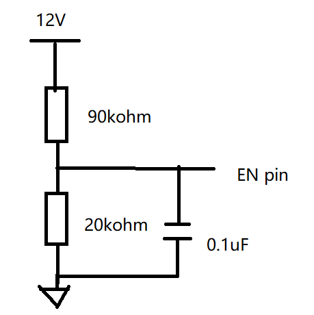

  • Hi, Sir
    Yes, you are right, 450kohm is pull-down resistor.
    suggest below configuration.
  • We tried this but this doesn't work as intended. If you have a evaluation module, please try this out and see the problem yourself. We also increased the value to a very high resistor value but still it doesn't work. The buck turns on at about 1V much before the threshold of 2V.

  • Hi, Sir
    Maybe you can try to enlarge the cap from 0.1uF to 1uF.
    I think the problem maybe at Vin slow rising up.
    Could you show me your schematic? and waveforms for inrush current, Vin and SW1? And could you tell me where do you measure the inrush current?
  • Increasing the cap to 1uF will further delay the rising time of the VEN pin voltage.

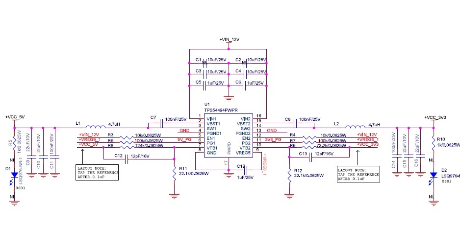

    Here is a snapshot of the schematics. I don't have the waveforms handy, will share on Monday. We are measuring the inrush at 12V input and see that after the charging of the input bulk capacitor, when the buck turns on there is a 1.5A-2A of inrush observed.
  • Hi, Sir
    1. 1uF will delay turn on the bucks.
    2. The schematic looks okay.
    3. The buck converter has ~1ms soft start time.
    Supposed 4 bucks work at the same time, according to Q=C*V.
    For 3.9Vout, Q=(220uF+44uF)*3.9V=~1030uC.
    For 5Vout, Q=(40uF+44uF)*5V=420uC.
    For 3.3Vout, Q=(44uF+10uF)*3.3V=178uC.
    For 1.8Vout, Q=(44uF+10uF)*1.8V=97uC.
    charging curent(inrush current) = total Q/1mSec=~1.7A.
    The calculated inrush current looks matched with your tested value.
    Because the soft start time is fixed, so i think there is no good method to reduce inrush current, the only method is to reduce the output capacitance, or don't turn on 4 bucks at the same time.
