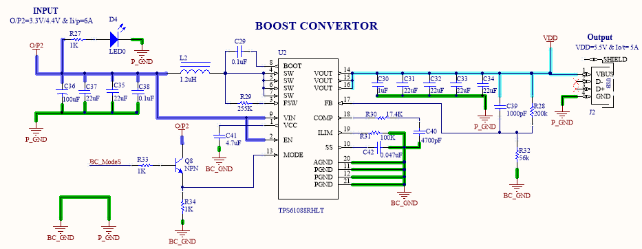

              We Design system to drive Raspberry PI and other load(1.5A), using BQ24773 for battery charging and TPS61088 boost converter to provide required power to the load
Currently we are using only raspberry as load  to system which I share schematic of boost converter and layout design
Because of odd value of Rfreq=R29 which 255Kohm as per the evaluation currently, we are using standard value which is 270Kohm but there is some noise(Humming Noise) when loaded the system that's why we try to adjust it by using 2 parallel resistor which is 1M || 330K ohms= 248KOhm, after the  R29 replacement check all voltage's it's shows properly but when we Connect Load(Raspberry PI) to the system  TPS61088 is short and dead ..?
Before that also we observe the damage's of TPS61088  because of overloading and insufficient input source when load was connected but it's over heat and damage permanently
What is the reasons of TPS61088 permanents damage..?
which protection available in the TPS61088, as per the datasheet the device provides 13.2-V output overvoltage protection, cycle-by-cycle overcurrent protection, and thermal shutdown protection if there is following protection available in the chip then why chip going to damage permanently..? and how to avoid this permanent damage of chip ..?
Any solid reason of R29 replacements can damage the TPS61088...?
We are operating TPS61088 in PWM mode by not mounting R33 & Q8 and R34=0ohm.
and R30 is used as 18Kohm instant of 17.4Kohm

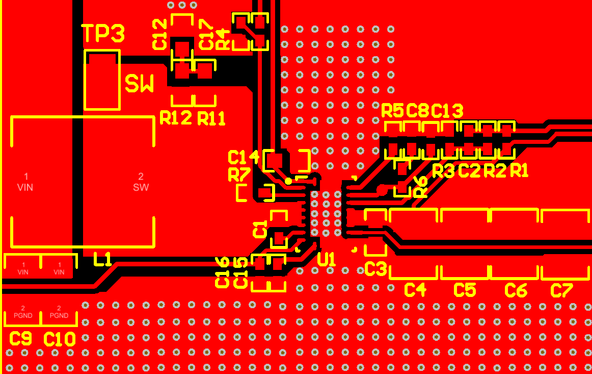

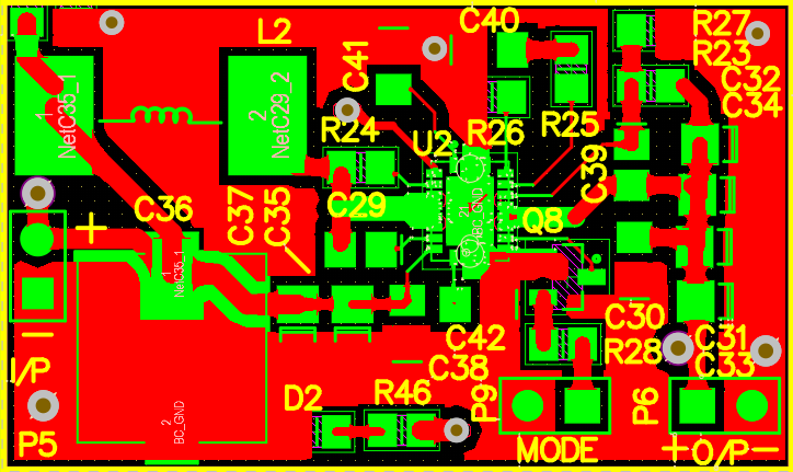

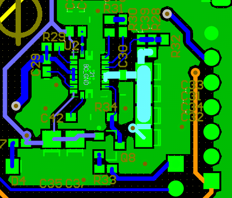

I am attaching 2 different layout ver. files of tps61088 booster which have same issues and schematic of TPS61088 boost converter, schematic file is for B2 layout

  • Dear Sir,
    The Layout is very poor.
    1. The inductors should be directly connect with the IC;
    2. The output caps C30-C34 should be placed as close to the IC as possible.
    Please refer to the TPS61088 EVM board and the information on the datasheet for a reference.
