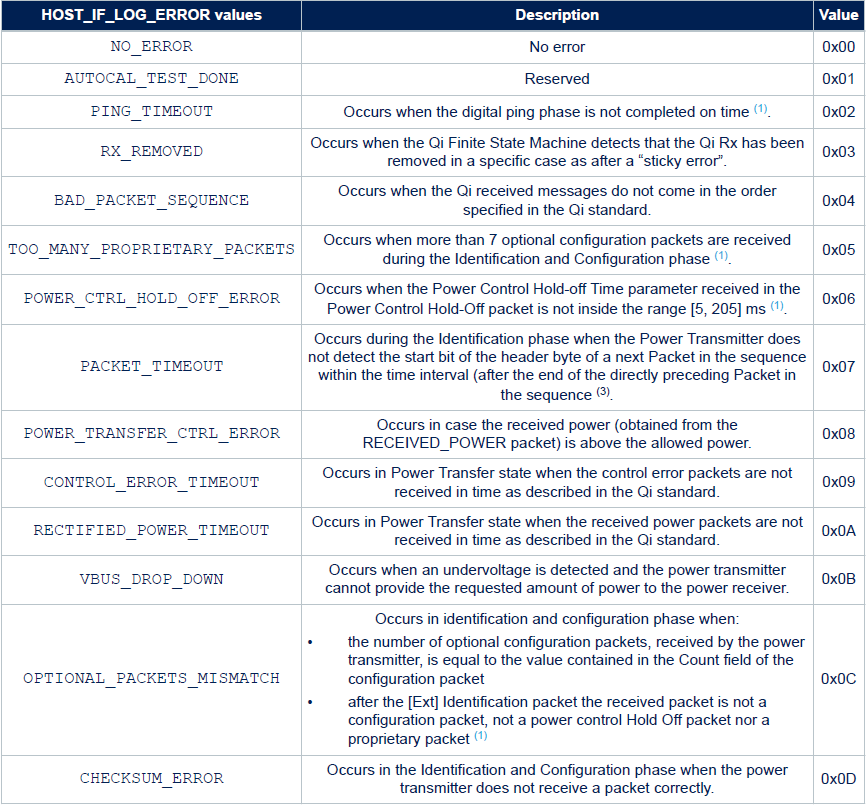

I have a design that uses the STWBC-WA on the wireless power TX board and a TI BQ5105xB chip on the receiver side and I'm having a hard time getting the handshaking and charging to work. I am using the STEVAL-ISB045V1 with the Tx coil swapped out with the coil we are using for our design. I have got it to briefly work and apply a arge, but can not get it to work consistently. The error code appears to be CONTROL_ERROR_TIMEOUT which is causing the three rapid blinking lights to restart the Qi handshaking process. I have got it to work briefly by tweaking some of the configurable parameters on the STWBC chip via the STWBC GUI 3.48 software, but I'm looking for any specific guidance regarding a CONTROL_ERROR_TIMEOUT and what settings might affect that. Both chips are Qi compliant and when we did get the power transfer to initiate, we were able to see the Manufacturer show up as TI from the receiver, so that is working correctly. I'm trying not to tweak too much as I'm not sure what can damage the boards. I can provide the schematics if that helps.
The error codes and their details from the datasheet are as follows (we are seeing CONTROL_ERROR_TIMEOUT):

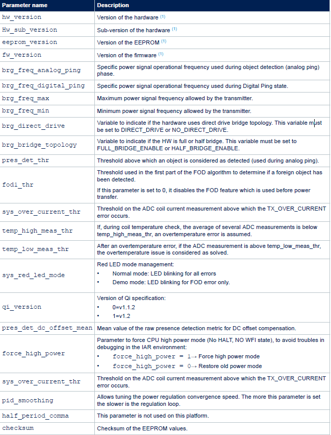

These are the configurable parameters we have to work with:

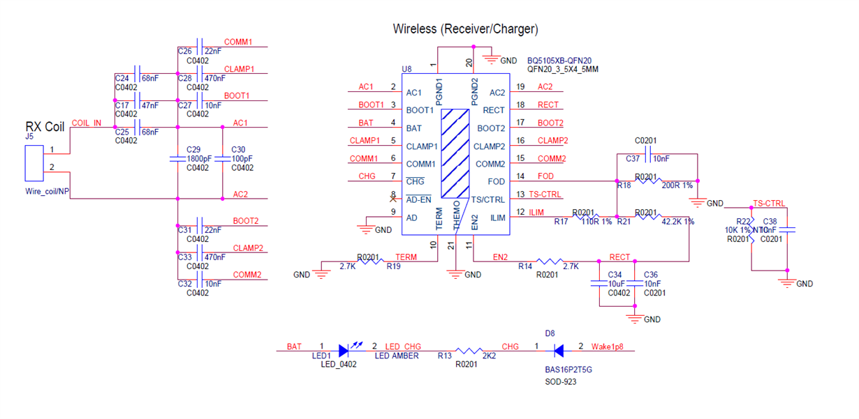

    Thanks for the reply. The TX must be decoding the packets to a degree because we did get the power transfer to work for about ten minutes at one point. The ST chip is for applications less than 3W. What dictates the DC level the RX is requesting from the TX? I assume the RX communicates to the TX what it is looking for in terms of a setpoint to charge and the TX attempts to match that. I'll include a screenshot of our schematic here.

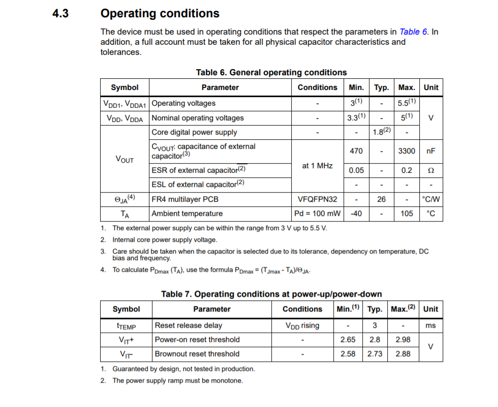

    How do I know what the operating point of the TX is? Here is what it seems like are the operating conditions for the STWBC-WA
    Is there anything we can do regarding the settings or if there is an issue will this be some component changes? It seems promising that we were able to get the power transfer to work for about 10 minutes. I really appreciate your help Bill.
