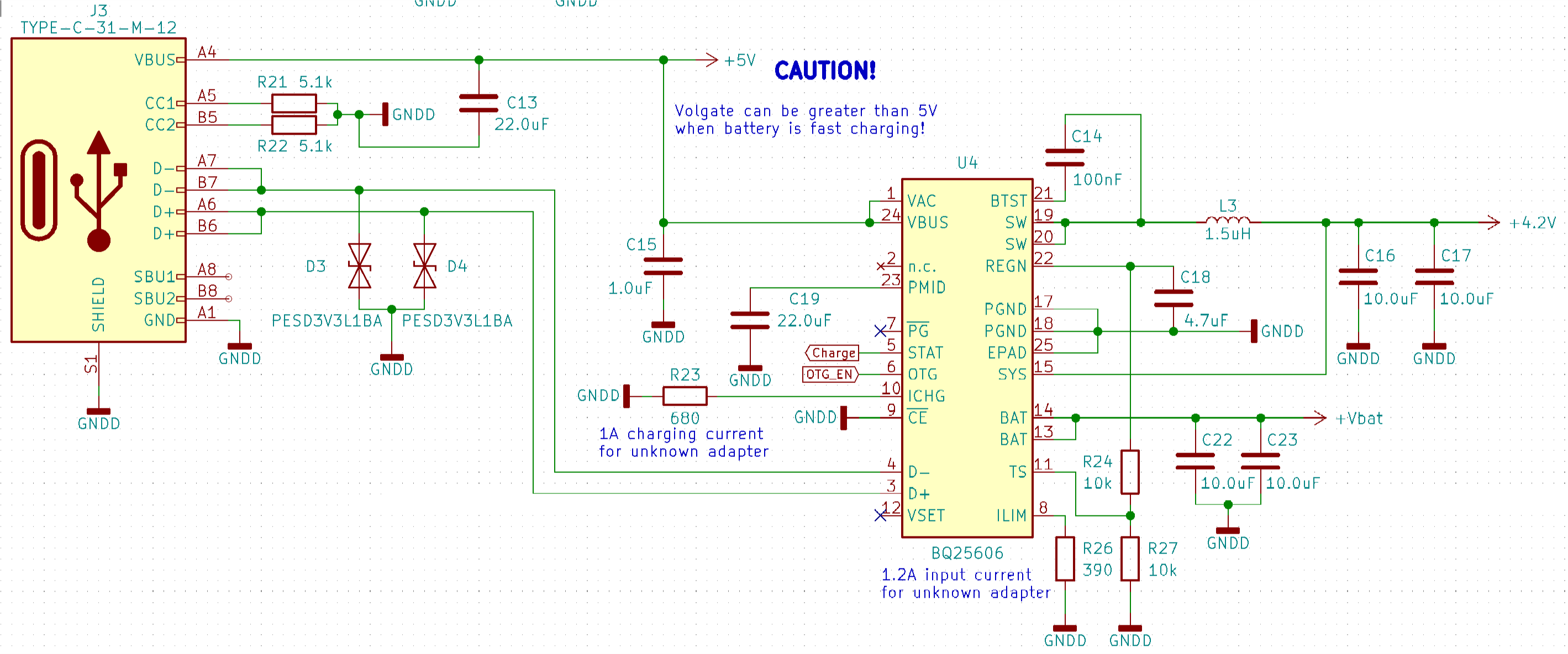

Hi everyone,
I have problem with this charger IC - charging current always 750mA, in case of any type of charger adapter ( with fast charge 9, 12, 15V, old 5V only, or even 5V from PSU).
And even IC can't detect charger type I'm expected 1A charging current. When I try set lower values for R23 and R26 to increase charging current BQ25606 becomes unstable - STAT LED starting blinking (5-7Hz) and
charging current goes to zero.
Without battery STAT blinking at 1Hz, In OTG mode I have 5.1V output with 0.8A load (haven't tested with higher currents).
Schematics below:
I would appreciate any help
UPD: C13 and C15 are located close to the IC, and C19 is the closest. I have two boards, and both with same behavior.
