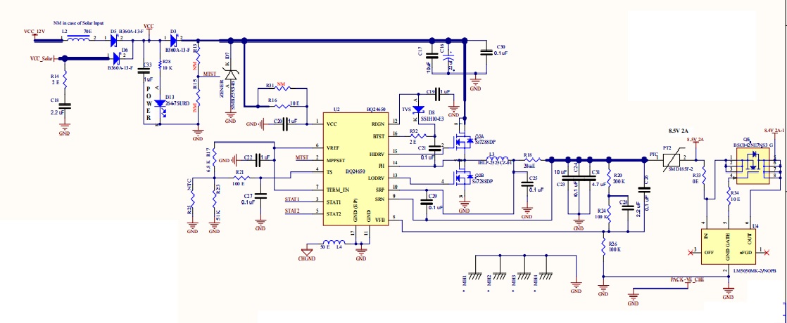

Sechamatic is given below
Please help for solving this issue

    Nothing in the schematic stands out to me as the issue right now.

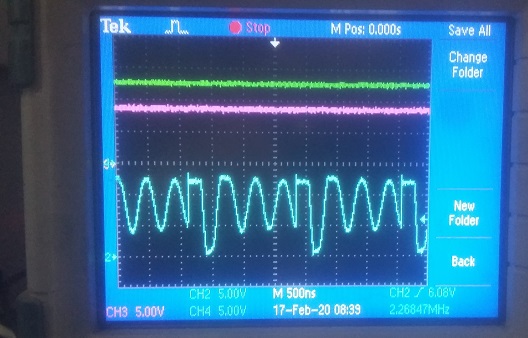

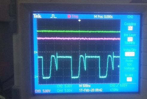

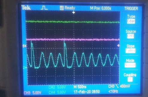

  • hello sir,
            please see the scope capture pic of VCC,SRNand ,PH
          Green line -VCC(12V)
         Pink Line-SRN
          Blue Line-PH
    First caputre(without battery)
    2nd and third capture(after battery insertion)
    3rd capture
    we have three channel scope.so can not capture cuurent
  • Hi Krishan,
      The charger operates in non-synchronous mode when the SRP-SRN voltage is below 5 mV (0.5-A inductor current for a 10-mΩ sense resistor). In addition, the charger is forced into non-synchronous mode when battery voltage is lower than 2 V or when the average SRP-SRN voltage is lower than 1.25 mV..
    From your scope capture on 2 and 3 after battery is inserted, the PH node is ringning when both FET have been turned off, as average inductor current is less then 0.25A (5mV threshold, across your 20mohm sense resistor)
    For scope capture 1, please re-take with 200ms or 500ms scale. Looking at PH node with small time scale will not tell us if battery absent detection is being implemented or not. At larger time scale, we can see if the internal sink and source currents are correctly attempting battery absent detection.
