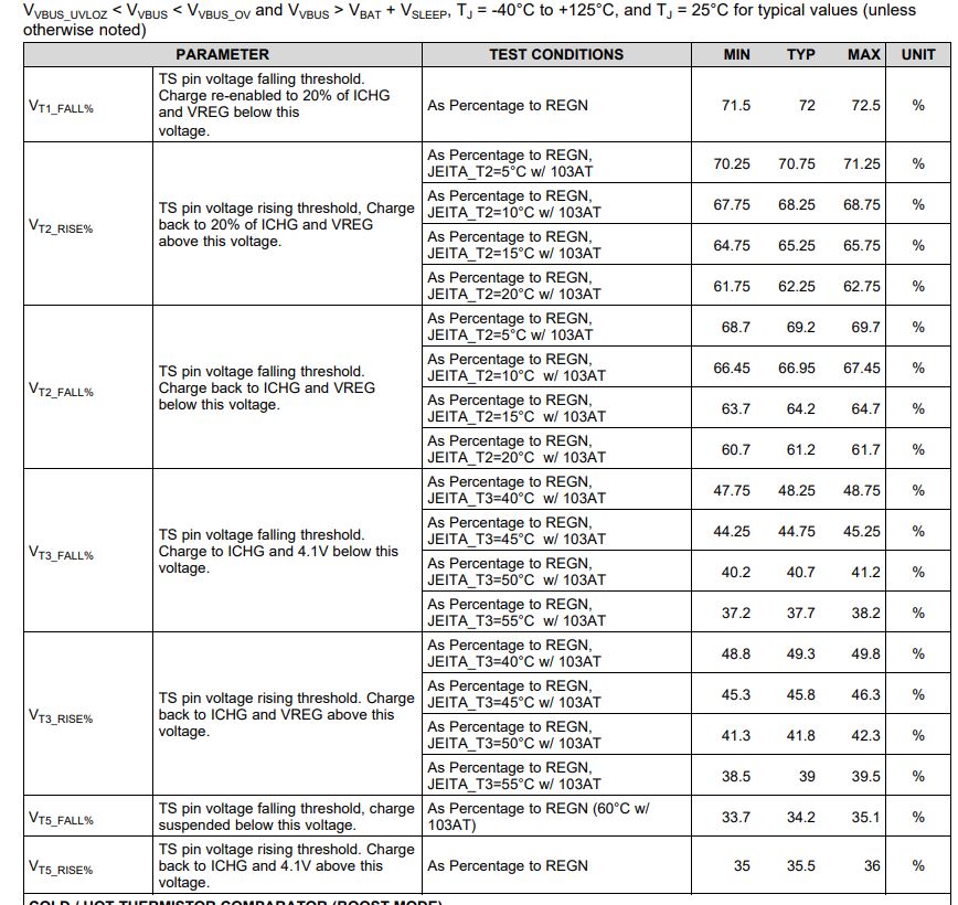

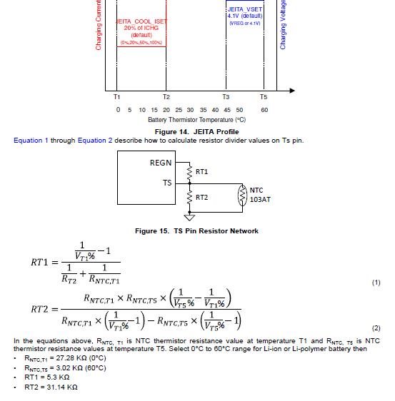

Dear Sir,
Cusomer asked about what tolerance for bq25619 charge temperature 0~60 degree C?
If we can use resistor's tolerance 1% to calculate difference between VT1% and VT5%, and + bq25619 tolerance, is it make sense?
