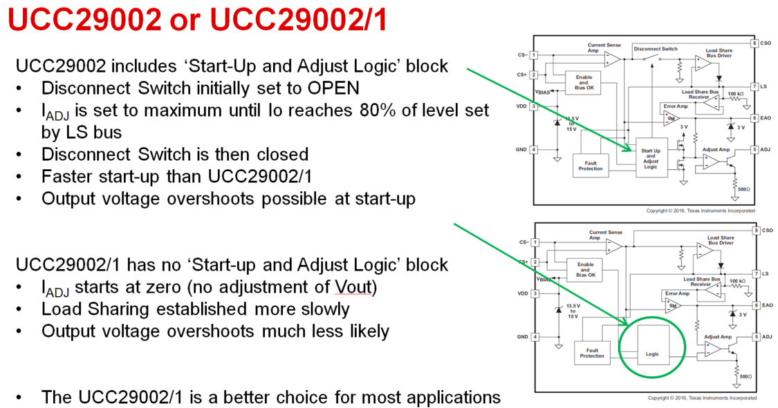

My customer want to use UCC29002, can you please help clarify difference between UCC29002, UCC29002-1 and UCC39002. Is it just package and temperature range difference? Thanks.

The only difference between the UCC29002 and the UCC39002 is the temperature range of these parts
The UCC29002 has a temp range of -40C to +105C
The UCC39002 has a temp range of 0C to +70C
The difference between the UCC29002 and the UCC29002-1 is the start-up as shown in below picture.
