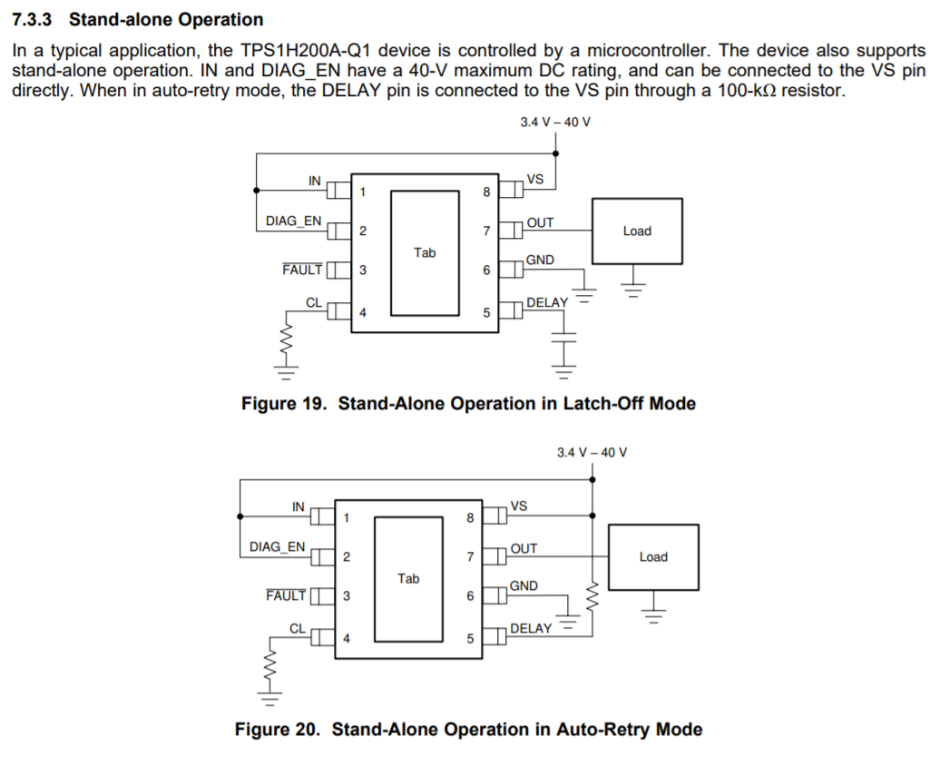

When Auto-Retry mode used, delay pin should be pull-up.
How ohm should customer select if pull-up to 24V?

Hello Tim,
thank you for your response.
It looks abs max for delay pin is 7V. is it really okay to pull-up to 24V with 100kohm?
best regards,
Kazusa suzuki
Suzuki-san
Yes this is OK. The DELAY pin in auto-retry mode is essentially a high impedance input to a comparator so there is not going to be enough current to hit the 7V absolute max here.
