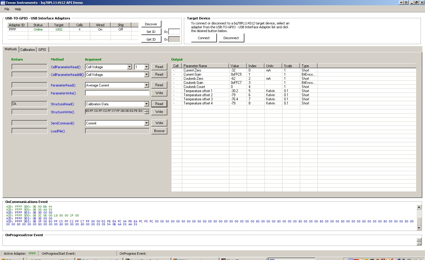

BQ78PL114S12 Calibration : Offset temperature Board ? and T1,2,3,4
Other Parts Discussed in Thread: BQWIZARD

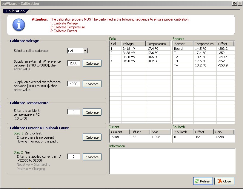

We want to verify that our temperature sensors are ok, checking the coherence of offsets.
In BqWizard - Calibration, all offsets are available.
In API, Read Calibration Data only gives me 4 offset, and values are not identical.
I can not find the offset of the board. And I can find the calculation that would allow me to find the same result?
Could you give me some information?
    Reponse of Texas
    It looks like the data structure called Calibration Data does have all the correct data and in the correct order.  (This structure is what would be saved in the bqWizard as a .cal file.) The problem is that the Parameter Name listing within that structure is not correct.  We have compiled a new API with a correction.  I need to check it first and then I can send it to you.
    Thanks for uncovering this bug in our software.
