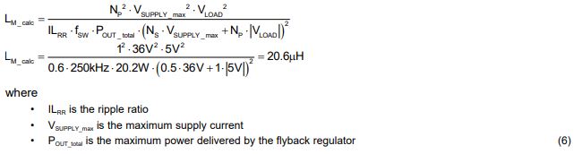

  • Hi Y. Ottey,
    Thank you for reaching out.  Transformer Lp is determined by setting the inductor ripple current.  Please refer to the following app note:
    http://www.ti.com/lit/an/snva866/snva866.pdf
    The equation that you use assumes 50% duty and it should not be 50% for both Vin=36V and Vin=8V.

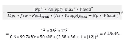

    I work with Ottey for this issue. And I tried to calculate that Lp value which is resulted by WEBECN with that equation on the App-note.
    But it does not match the calculation result of WEBENC.
    My calculation result was 83uH. (WEBENCH result is 6uH)
    Could you give me advice what is wrong with my calculation?

  • Hi Hamamoto-san,
    Thank you for chiming in. I am afraid you used a wrong value for Ns.  It should be 1/0.42.
    For flyback transformer selection, the min VIN is used in general, because the highest peak current occurs at the min VIN. I followed your conditions and also the equations in the App Note (yes I changed Ns to 1/0.42=2.38), and I got minimal Lm=3.2uH.  You should choose something not smaller than that.
    Note that Webench is a good tool and it can give you a good start point, but t also has limitations because the Webench mode references to the EVM circuit and also its limited part library.  My recommendation is to use the Webench to start a design, then cross check with the calculations, and make some updates.
    Youhao Xi, Applications Engineering

  • Hi Hamamoto-san,
    You need to use min VIN instead of max VIN for the calculation, because the flyback transformer is basically determined by the min VIN which has the max peak current.  When you replace it with 8V, you will get about 3.2uH.
    Youhao

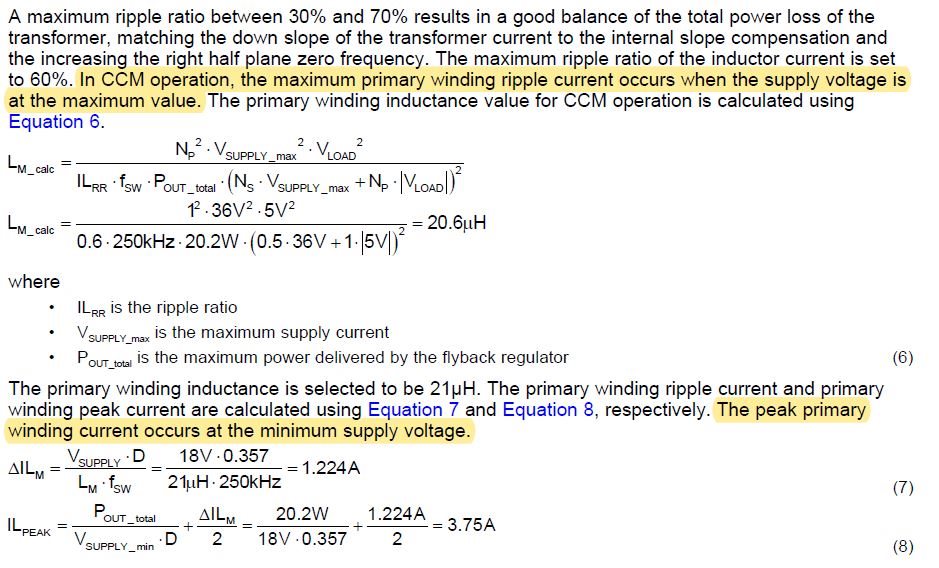

  • Hi Youhao-san,
    I appreciate your support. I am still getting confused for this calculation.
    On the datasheet it is mentioned as bellow,
    As it's mentioned on above datasheet, Lm is calculated at max Vin condition because the max ripple current is at max Vin condition.
    So, actually which condition we should calculate Lm at?
    Koji Hamamoto
  • Hi Hamamoto-san,
    Sorry for the confusion. Designing a power supply is always an iteration process with trade-offs. The app note assumes CCM throughout the input voltage range, and it is a good start point.  However, you need to check both conditions to get a design with the min BOM cost. When you compare the Lm selected by low Vin, you can decide which is a more suitable selection for your application.  Either one should work.
    Youhao
