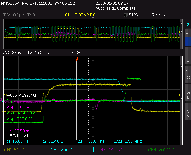

    Burst Mode at low load is shown here.  Blie V_QA_d; gelb: V_QDg; lila: Ipri
