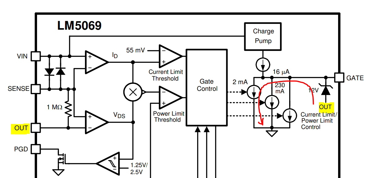

we are using the LM5069 mainly as inrush current controller when we power up a Load. VIN is at 48V the max current is approx  450mA. Our Design is more or less the same as the typical application diagram on page 1 from the LM5069 datasheet. The Load can be physically attached respectively removed from from the LM5069 over a dedicated connector.  To shutdown the load we remotly switch off the LM5069 by pulling the UVLO pin to GND. To check if a Load is connected while the UVLO Pin is pulled to GND but VIN is at 48V we put a probe Voltage approx 5V to the Load and check it with an ADC. In this setup we see that the OUT Pin of the LM5069 draws around 6mA. Please explain us we the OUT Pin is drawing around 6mA, since we did not found any hint in the device datasheet.
Attached you will find the relevant page of our schematic.
So VIN is at 48V. UVLO is pulled to GND over a FET and a probe voltage
thanks and kind regards,
DavidLM5069_DETAIL_TI.pdf
