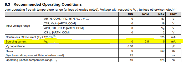

Hi teams,
If my customer wants to use pin 2 (VB) to power another device, how much current can pin 2 power?
