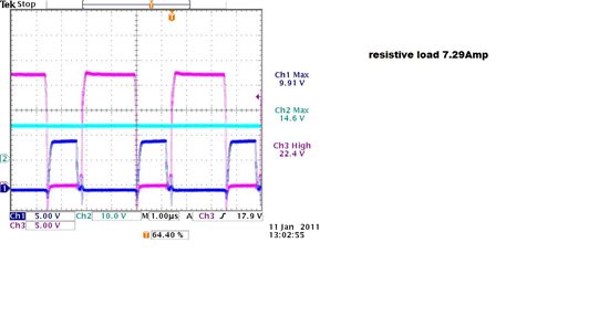

I made the modifications,using a bench with a variable resistor as Load i can get the system working till 6 Amp at 14Vout this means 7*14=84 Watt.
I put in and take out the load the system is working correctly.

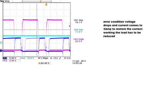

That is the power I get out with the resistive load. Now, when i load the 14 Vdc PWs with the ''BRIDGE LoAD'' the PWS in 100us start with the one pulse long one short the out voltage drops at 10 volt and till the load is applied the system works in this way.

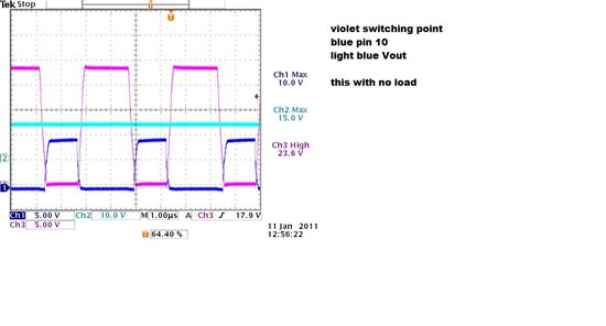

Bu looking at the switching point what i do not understand is, by changing from no load condition to load coundition the waveform at the switching point is nnot enlarging the
working duty cycle but is changing a litte bit the shape it becomes from a pseudo trapezoidal to a quasi rectangular
as showed in the pictures
What can I do? where i'm wrong regards mganzetti

    The TPS40055 controller is a fully synchronous, fixed frequency BUCK converter, even at zero load, the synchronous rectifier is driven fully complementary to the main switching FET so it's duty cycle is nearly the same at no load and full load.  Fro 24V to 14V, this is about 60%.
    You can disable current limit by removing the resistor between VIN and ILIM.
    I did some graphical comparisons between your No-load operation and 7A operation above.
    1) At 7A load current the switch node pulse width is approximately 150ns longer than at no-load.  This is the TPS40055 controller's error amplifier loop compensating for the losses in the Power Supply.  This would represent 6.5-7W of loss being compensated.
    2) The SW voltage at the of the switching cycle is 1V - 1.2V lower at 7A load current than at No-load.  If the Input voltage is actually 24V, the voltage drop to the switching node appears to be 1.5 - 1.7V.  The switch node dropping so low would be consistant with the supply still entering current limit.
    You may want to check the DC voltage at the drain of the high-side FET at No-Load, 3A and 6A plus the AC ripple on the drain voltage at the same 3 load current.  These numbers are suggesting that you're experiencing a lot more drop from your 24V source to your power supply than expected.

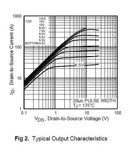

    I look at the mos I use now the IRF3205 well are no logic level mosfet so can be also that the 8 volt gate
    given by the device is not enough to full saturate the mos, do You think that could be usefull to try to use
    the IRL3803 that is a 30 Vdc device 140 Amp but is also LL device
    If we look at figure 2 from the IRF3205 datasheet
     We see that even with a junction temperature of 175C the MOSFET's 8V Vgs saturation current is over 200A with a forward current of 60A representing a 1V forward drop.  Even at these elevated temperates, the forward drop across the FET at 10A should be less than 200mV with a gate drive as low as 5V.  Using the TPS40055 controller, which provides 8-10V of gate drive voltage, the IRF3205 should be fully saturated.
    The IRL3803 does offer a lower Rdson at 8V verse the IRF3205, however it does it at significant expense in switching speed.  The IRL3803 MOSFET has 50% more switching charge (100nC verse 70nC from maximum datasheet specifications) and considerably higher total gate charge at 8V gate drive (140nC verse 78nC from typical Vgs verse Qg curves) It is unlikely that the improvement in Rdson will overcome the significant increase in driver current, switching and gate drive losses.
