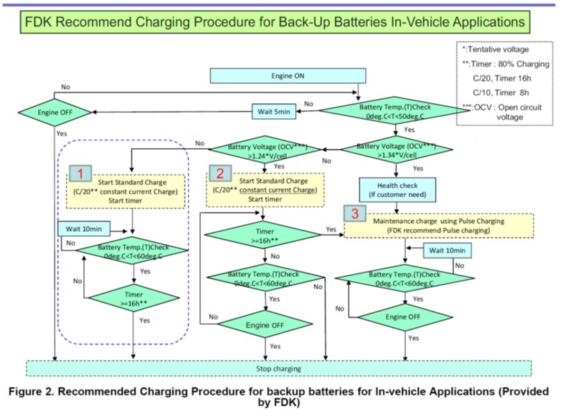

My customer have some question about FDK Recommend Charging Procedure for Back-Up Batteries In-Vehicle Applications
1. There are three different charging procedures depending on the battery voltage.
Even when not using an external MCU, does the BQ24105-Q1 decide which charging procedure to use by itself ?
2.Please tell me the content of health check.
In addition, it says "If customer need", how do you set the presence or absence of a health check ?
3.Customers are aware that the timer charging method charges at a constant current for a predetermined time.
Isn't the battery voltage checked during charging ?
Even if it is fully charged, will it continue charging until the set time expires ?
4.If a temperature abnormality occurs during charging of the timer or the engine is turned off, charging is stopped halfway, and charging is restarted, will the timer be reset ?
Or is the timer counted from the last time ?

  • Hi Hayashi-san,
    Regarding 1, no, the BQ24105-Q1 can only terminate based on battery voltage and termination current.  It needs the mcu and software to decide when to terminate.
    Regarding 2, I suggest consulting the battery vendor to obtain the impedance cut off value for a healthy battery.
    Regarding 3, NiMH battery voltage varies by temperature. At different temperature, the full charge voltage is different. Figure 5 in the app note below shows this.
    Regarding 4, when TS pin detects a temperature fault, charging is suspended but the safety timer does not be reset.
    http://www.ti.com/lit/an/slua843/slua843.pdf
    regards,
    Jeff
