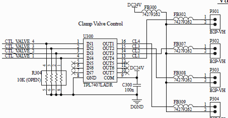

I am facing TPL7407LADR burnt issue during power up. (when plug in power connector with DC12V and DC24V existed)
Refer to below image,
There is nothing connected to P301, P302, P303 and P304.
All the controlled signal (CTL_VALVE_1, CTL_VALVE_2, CTL_VALVE_3, CTL_VALVE_4) state during power up might be unknown.
DC12V and DC24V GND joined together in my PCB.
All the controlled signal are powered from DC12V (via DC-DC step down to MCU).
What is the possibility for it to be burnt up?
2 cases happened.
Please help to advise.
