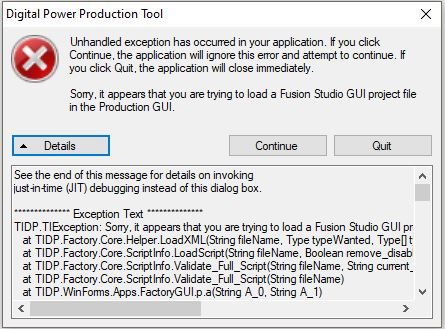

UCD9248: The UCD9248 programming is not working properly.
Part Number: UCD9248
Hi Team,
We are currently working on the design with the combination of UCD9248 and PTD08D210W.
The reference design is taken from Xilinx ZC702 Evaluation Kit. We are going to fabricate 200 numbers of PCB. We are facing issue with the Fusion digital power supply design software.
When we try to program the module, frequently it gets failed and after many attempts, it gets programmed. Is there any other method to program the module?
We are using Fusion Digital power design 7.2.1
We are using, .tifsp file format.
