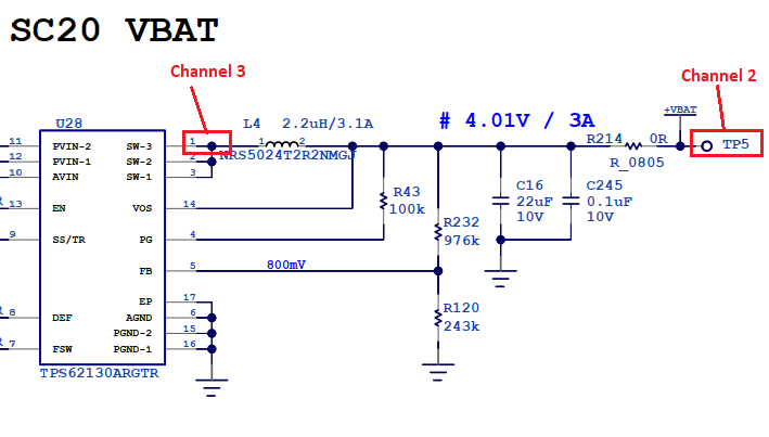

I meet an issue when using TPS62130A as power supply IC to supply 3V8 for main power VBAT of MCU SC20 Module from Quectel.
To describe my issue, I will you the information:
  • MCU SC20 Module recommended input voltage range: from 3.5V to 4.2V
  • Schematic and Layout Design: the same as ref design of TPS62130A datasheet
  • Input Voltage: 5V @ 5A max
  • Output Voltage: 4.01V
  • Switching Frequency: Connected to GND => fsw = 2.5MHz
  • DEF pin: Connected to GND => Nominal scaling output voltage.

  • Trong,
    Actually, the load regulation may vary by about 30 mV between light load and PWM operation as shown in the datasheet Figure 22.  However your case is more like 200 mV, which is abnormal.  Did you follow the datasheet layout guidelines precisely?  In the mean time I would like to see more waveforms.  Pleas zoom in and trigger on the rising edge of the VOUT voltage increase.  To start with let me see VOUT, the SW node voltage and the load current.  Do the same on the falling edge.  Try 2 usec / div and 10 usec / div.  Increase the time scale further if needed to get a clear picture.

    Measurement point:

  • Trong,
    This looks like a simple case of loss in your circuit.  In the places where Vout is higher there is no switching because the load is light or no load.  There are no losses as there is no current draw and the output voltage is higher.  When the load is applied, the device starts switching.  The loss in your PCB layout is likely causing I*R voltage drop.  Let me know if you can upload the PCB layout.
