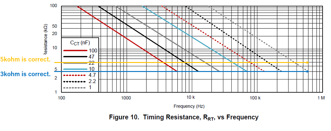

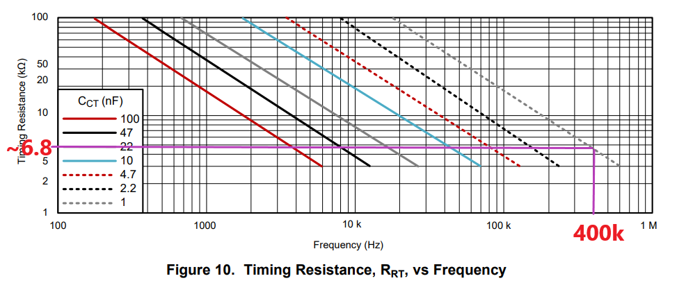

Hi Team,
We understand that UC3843 can set up to 500kHz operation and we would like to set fosc=400kHz.
However, if CCT is 1000pF(=1nF), RRT is 4.3kohm so out of recommended range of RRT(5kohm to 100kohm).
Could you please let us know the recommended combination(CCT and RRT values) for fosc=400kHz?
