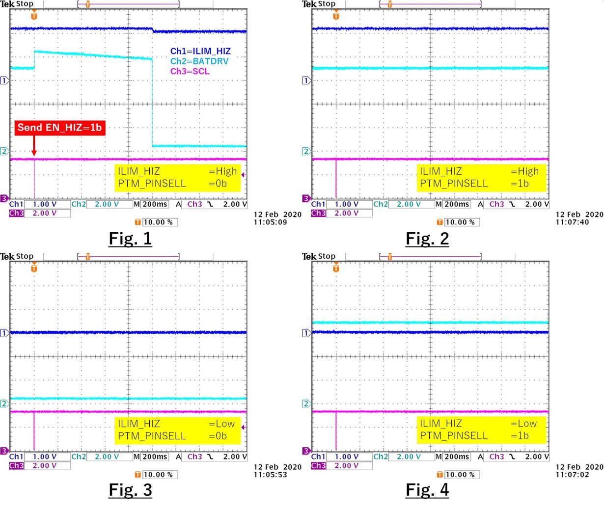

Please let me ask about EN_HIZ bit under PTM_PINSEL = 1b.
I understand that EN_HIZ bit can be used to enter bq25713 into HIZ mode. Then does EN_HIZ bit also work when PTM_PINSEL bit is set to 1b?

The PTM_PINSEL bit only impacts the function of the external ILIM_HIZ pin when it is pulled low.

Did you follow the steps described in section 9.4.3 Pass Through Mode (PTM) of the datasheet?

Thank you for your comment. I understand that the EN_HIZ bit is ignored after PTM_PINSEL is set to prevent bq25713 to enter Hi-Z mode accidentally during PTM mode.
