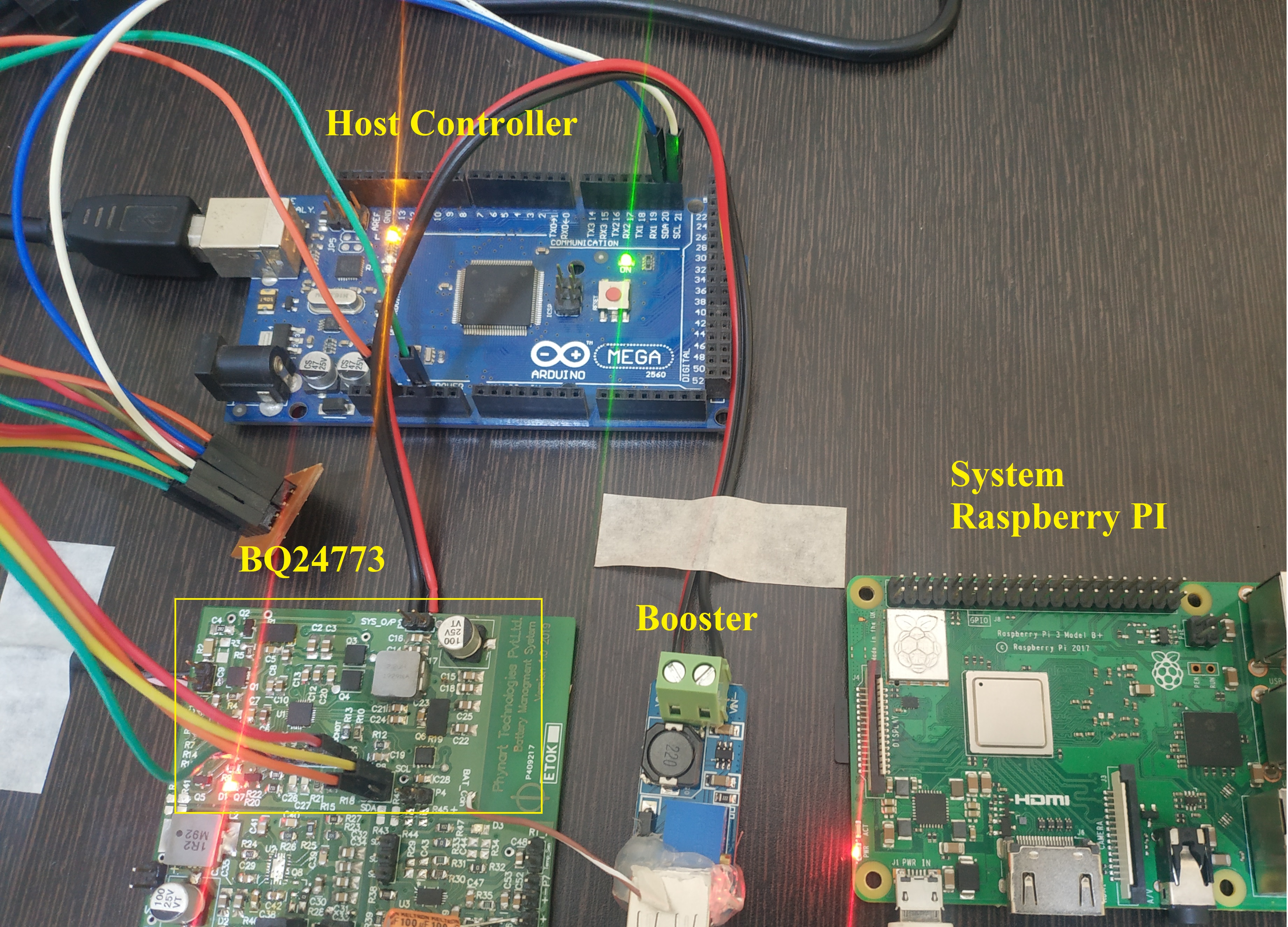

We are using BQ24773 to power the system load (Raspberry PI 4B)
In our BMS system we use different components like BQ24773, TPS61088 and BQ27542
This integration we are using for one of our consumer product to make it portable
Battery is 5000mAh Lithium Ion cell
Try different Adapter
1. 5.6V/2.4A wall Adapter
2. 5.2V/3.1A wall Adapter
3.5.5V/5A SMPS
4. Variable DC source 24V/2.2A
we have some power source requirements from this BMS design Like,
1. System (Raspberry PI) can work in the absence of battery (Power by adapter)
2. System (Raspberry PI) can work in the absence of adapter (Power by battery)
3. System (Raspberry PI) can work in the presence of adapter & battery
System is working on all above 3 state when it's configure by host controller, we want to show that system is configuration done indication to developer, How it is possible to provide it ..?
System is working on only 2 and 3 state when it's not configure by host controller, not going to work with 1 state..?
We set same command value which is in default configuration setting for to configure system by external host there is only change is that Input current is set- 2A
Why not system is going to work on default configuration setting ..?

  • Hello Joel,
                     I am sharing the video of my system boot up problem, i think it 's helps you understand  the issue
    In video,
    1. It's Try to Boot up without configuration by host controller, which i need to resolve (In this case BQ24773 need to Run with default setting right..?)
    Observe the ACT Green LED on Raspberry PI, It's try to Boot system but failed every time
    Default Configuration is,
    Sr.no Register Reg.Add Default
    Configuration
    1  ChargeOption0      0x00  0XE34E
    2  ChargeOption1      0x02 0X0211
    3  ProchotOption0     0x04 0X4B54
    4  ProchotOption1     0x06 0X8120
    5  MaxChargeVoltage  0x0C 0X1130
    6  ChargeCurrent      0x0A 0X0000
    7 MinSystemVoltage     0x0E  0X0E
    8  InputCurrent       0x0F  0X2F
    9 ChargeOption2      0x10  0X80
    The Reset Button press on Arduino to Configure the BQ24773
    2. When system is Configure By Arduino It's work Properly, Configuration set same as Default Not changing anything (Work Properly)
    Observe the ACT Green LED on Raspberry PI, After the system Boot-up is completed it's stable down also check WIFI by SSH and all other services also work properly
    Sr.no Register Reg.Add Arduino
    Configuration
    Can you provide a schematic for this? please check the attachment
    Thanks and Regards,
    Rahul Surawase

  • Hey Rahul,
    Even if there is no battery present, the MaxChargeVoltage() register defaults to 4.2V, not to 4.4V. That is why I asked if you read the registers before and after writing the settings?
    I suggest you use a BQ24773EVM an test in parallel. Make all the modification to match your board (specifically the CELL pin connection to GND and the ACDET resistor divider). You can likely leave everything else the same.
    And you can do two things:
    With your custom board: Use the EV2400 communication device and tap into the I2C lines of your board and use BQStudio to monitor/program the settings.
    With the EVM, use your Arduino/Raspberry Pi and apply the same loads to the EVM and see if you have the same issue.
    Joel H
