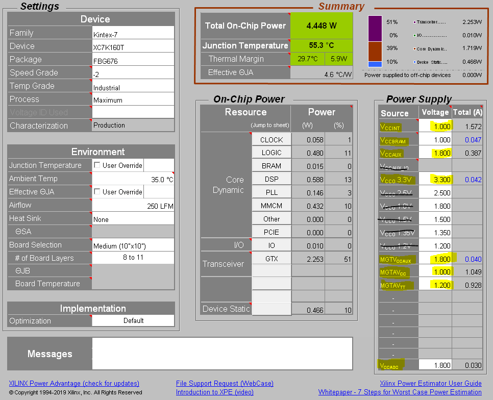

    Please find the attached Power estimation sheet.

  • Shifali,
    Based on your XPE file, it appears to me that you now have 3 choices, and the correct answer would depend on: (a) the input voltage, (b) the rest of the system, and (c) whether you prefer programming a PMIC or setting output voltages manually.
    • TPS650861 - If the input voltage is in the range of 5.6V-21V and the rest of the system is complex, the TPS650861 is still a good choice. You can use DCDC1 to generate 3.6V from the higher input voltage supply and use BUCK3/4/5 to generate the VCCINT, MGTAVCC, MGTAVTT rails and LDOs to generate the rest of the rails. DCDC2, BUCK6, and VTTLDO would be un-used, but it would still be a very cost-effective design.

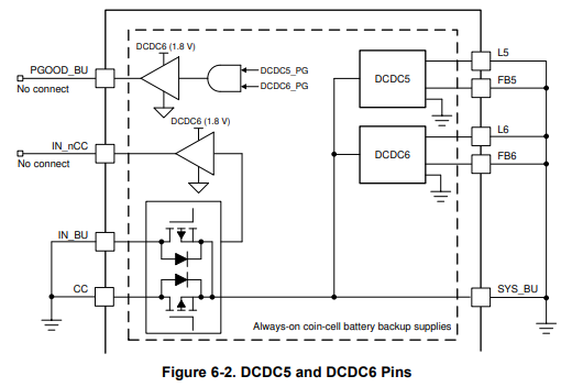

    Case 2: Using TPS6521815 in my design.
    I wil,be using DCDC1 to DCDC4 and 1 LDO. I will not use DCDC5 ,DCDC6 and load switches. Can i leave pins open/ floating.
    Please refer to TPS6521815 datasheet, page 93, section 6.1.2 Applications Without Battery Backup Supplies
