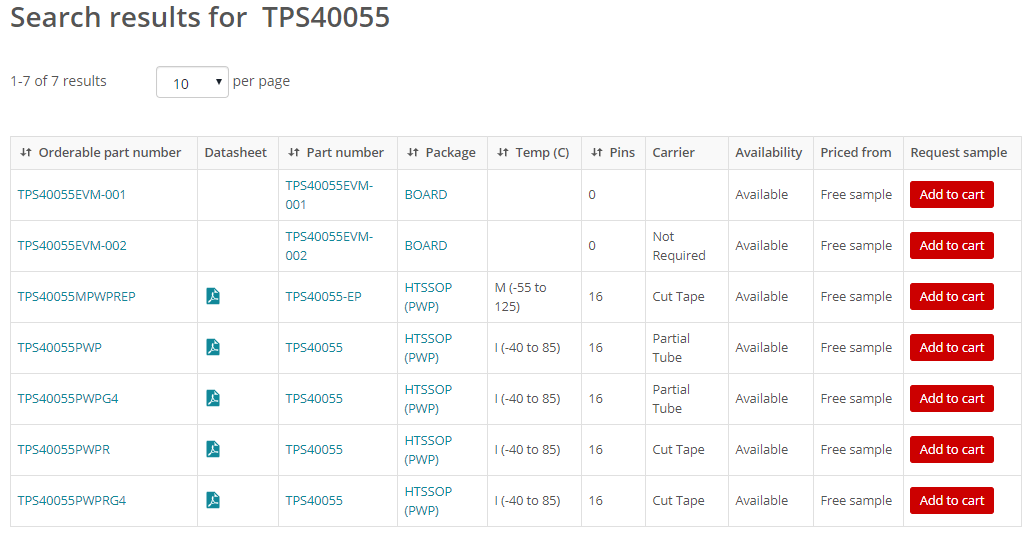

Finally, when searching this component with the parameters
  • TPS40055
  • 10-25V INPUT
  • 7V OUTPUT
  • 15A OUTPUT
into your WEBENCH tool, nothing appears... has this design been removed? If so, why is it still possible to use your SwitcherPro Software? www.ti.com/.../SWITCHERPRO
