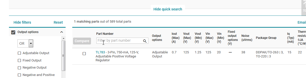

You do not answer the question what is the minimum voltage at the input of the regulator before "stalling". See below
7.3 Recommended Operating Conditions you don't give the VI-VO Min
In this document Vin_min 20V it 's correct ???
YD

Hi Jason Song
Vin (Min) 20V
I repeat my question
Hi Druilhe,
I would say Vin min on our spec table in the LDO search page is wrong. Vin could be lower than 20V based on the current load, Vin needs to be higher than Vout + Vdorpout.
