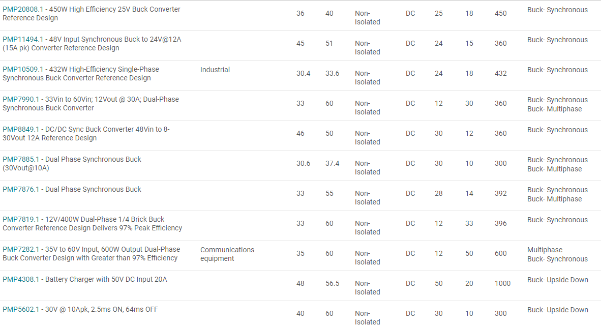

    If you prefer to use a buck converter, here are reference designs for your reference, you can find them on TI.com.
    Teng
  • I don't see a solution here for 36V output at 1kW (900W typical).  I would consider using bucks in parallel if I can get the appropriate power and there are application notes for how to wire them in parallel appropriately to share the load.
  • Hi James,
    Sorry, there is no available reference design with your requested specs, but I think you can still refer these reference designs.
    Besides, load share controller UCC29002 (UCC29002-1, UCC29002-2) is recommended to parallel multiple independent power supplies.
