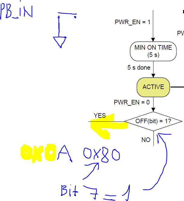

  • You do not need to perform all of these steps manually. You simply need to set OFF=0b && PWR_EN = Low.
    Set OFF=0b (Register 0x0A, bit 7):
    os.system('i2cset -f -y 0 0x24 0x0A 0x80') # OFF bit set to 0b
    I do not know how to re-write your code to set PWR_EN pin of PMIC low, but it must be high for the PMIC to be in the active state. You will need to figure out which GPIO is assigned as PMIC_PWR_EN and how to control the logic level of this signal.
    When PWR_EN is set low (after PMIC is in ACTIVE state for min On-time of 5s), PMIC will go to OFF or SLEEP state depending on value of OFF bit in STATUS (Reg. 0x0A).
    The text you are referring to in the image you provided, which says:
    "DCDCx = OFF
    WLED = OFF..."
    Is a summary of the PMIC blocks that are enabled or disabled in this state. The PMIC enables or disables the blocks automatically depending on which state it is in, not the other way around.
    Let me know if this helps.

  • Hello Brain,
    Thank you first, your answer and Info, From the picture below, I pressed PB_IN, which means PB_IN = 0, what is happened or how can I set PWR_EN = 0, bevor i do i2cset  -y  -f 0 0x24 0x0A 0x80 (bit 7 = 1  go to power off). Aber das Processor AM335xZCZ don't go to power down
    Please explain to me how I can influence PWR_EN = 0 or 1 or how send signal to PWR_EN. Please sorry uncomfortable question, and thank you very much
    Best wishes
    lijomi
  • lijomi,
    Entering the OFF state should be achieved using standard Linux commands. For example:
    sudo power off
    sudo poweroff
    shutdown -h now
    Should all shut down the AM335x processor and set the PWR_EN (PMIC_PWR_EN) signal low with OFF (bit) = 1b
    Entering the SLEEP state is also achieved with a relatively common Linux command:
    echo standby > /sys/power/state
    Should enter the STANDBY state of AM335x processor and set the PWR_EN (PMIC_PWR_EN) signal low with OFF (bit) = 0b
    In both of these cases, PMIC_PWR_EN is controlled automatically by processor, and the ability to control this pin is handled by the Linux SDK provided by TI. The TI Linux SDK and TPS65217 Linux driver work together to set/reset the OFF bit in the PMIC automatically.
    You should not have to write i2cset commands manually. Trying to control individual bits of the PMIC is making the procedure more complicated than necessary.
