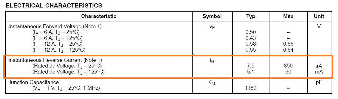

    At this time, I would like to confirm about the characteristics protection diode.
    According the datasheet, the protection diode will be located GND to TIMER pin.
    For instance, the discrete SBD has the reverse current(IR_leakage) and it has the thermal co efficiency.
    I am guessing it influenced the timer period to be longer, especially under higher temp.
    Is it possible to confirm the IR of protection diode &  the thermal co efficiency?
    You don't need to assure that, the design spec is enough.
    It was depended on the results, but possible to make the final answer without your loading for the checking.
    H. Sakai

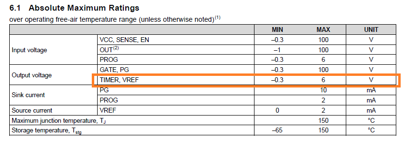

  • Hi Sakai-san,
    The timer sourcing current has variation from 15uA to 34uA with 25uA as typical. This variation accounts for all the process, temperature and internal circuit tolerances.
    For 1uF timer cap, the typical timer period is 160ms; max timer period is 266ms and min timer period is 117ms.
