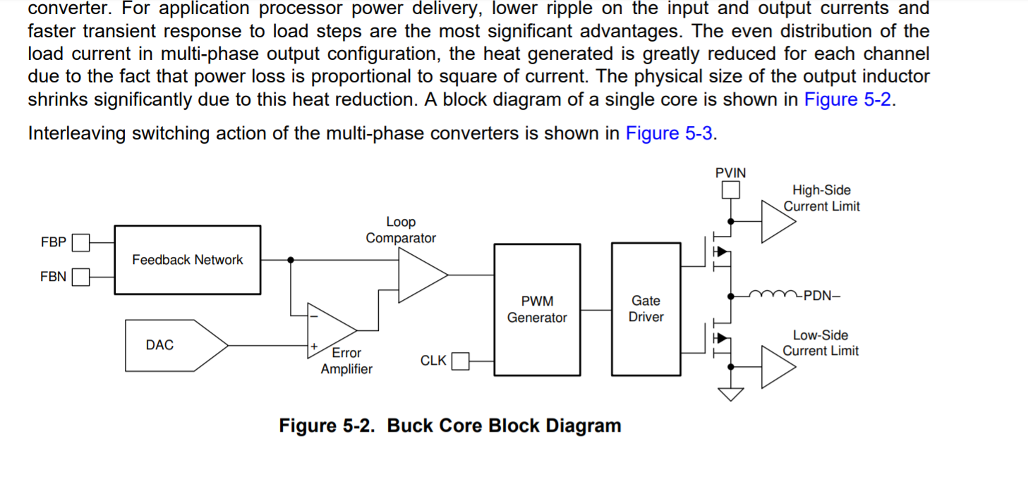

For PMICs, the sampling method of the BUCK circuit includes differential sampling and single-ended sampling. Are there any advantages or disadvantages of these two methods? Or which method is generally used?
In addition, some of the sampling feedback networks are direct output voltage sampling, while others use remote input (power supply IC) input sampling. And in the manner of differential sampling. Can use single-ended sampling in this case? Thanks.

      The differential sampling can cancel common mode noise but needs 2 pins; single-ended sampling can't cancel common mode noise but needs 1 pins.
      The TPS6594-Q1 device has only one pin for single-ended sampling when it's configured as single-phase; when any multiple phase is configured, and then differential sampling is used by using the other rail's feedback pin as FBN.
      Please follow TI's reference design for all bucks phase configuration.

       It depends on how solid the return path is. If the device has 2 pins for differential remote-voltage sensing, it's better to use them as they're designed.

  •   Yes, from performance point of view, differential sampling better than single-ended sampling.
