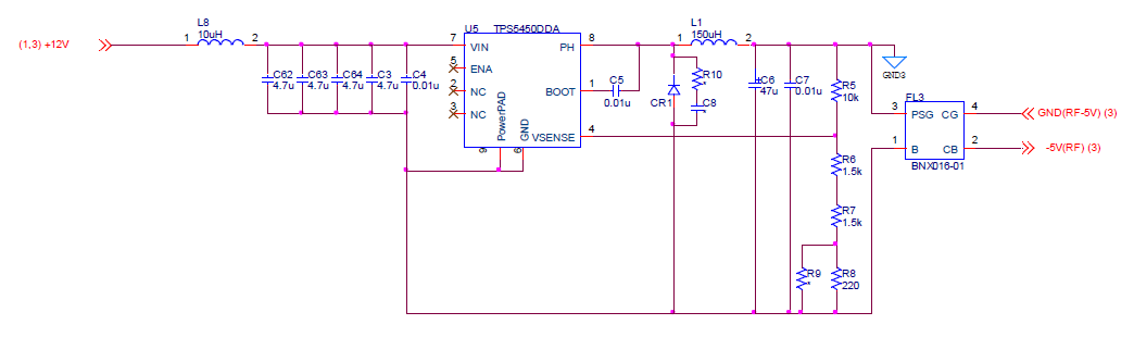

Please review below schematic which is VIN=12V and VOUT=-5V (negative voltage)
best regards,
Katsu

Hi Ivan-san,
Thank you for your support.
let you know the value of components.
R10: open or 39ohm
C8: open or 1000pF (these are snubber circuit)
R9: open (to adjustment of output voltage)
CR1: M2FH3-5063 (ShinDengen)
best regards,
Katsu
For the 5V output, you can use a smaller inductor. I think 15uH should be fine. Besides, please make sure the RMS and saturation current of inductor can support your load. Thanks.
15uH inductor will be considered.
is there any other concern in the schematic?
Katsu
The TPS5450 setup is OK from schematic if CR1 also meets your load. Thanks.
