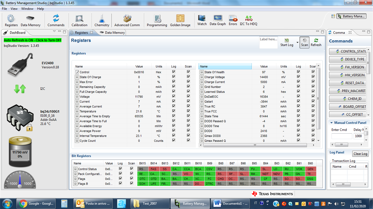

Good morning,
I'm using the BQ34Z100-G1 in a 9S NiMH battery pack. I selected the CHEMID accordingly to specific tests on the cell and using your online tool, so the chemical of the cell should be ok.
I followed the procedure for creating the golden file (applied several time to other battery packs) and I programmed 20 packs for first tests.
After charging, I leaved such packs in the warehouse for a few weeks, and, after that, I found the SOC indication at 0 value. It is not coherent with the voltage of such a packs and with a specific capacity test (i.e. the measure of charge during a full discharge cycle).
Is there any reason for finding SOC=0 after a long rest period in the warehouse?
Just in case it will happens again, is there any procedure for restoring the proper SOC level? For example, on a pack I changed the "load select" from 3 to 1 and the SOC value jumped to a correct value.
Thank you in advance for any help
Best regards
Matteo

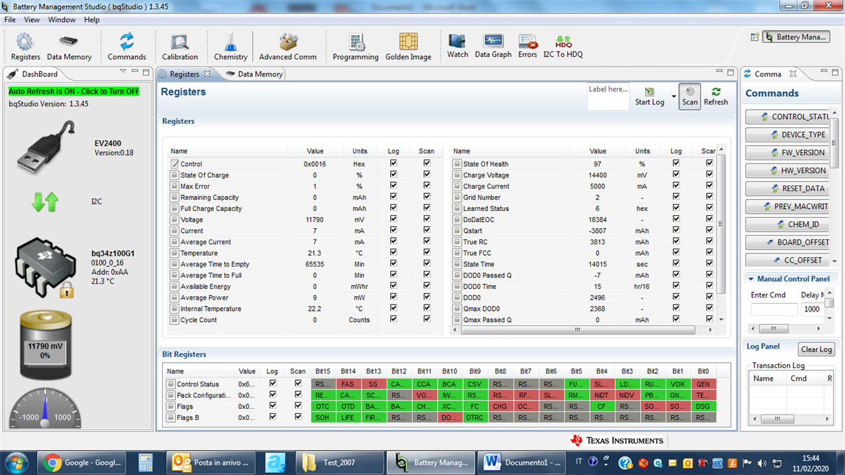

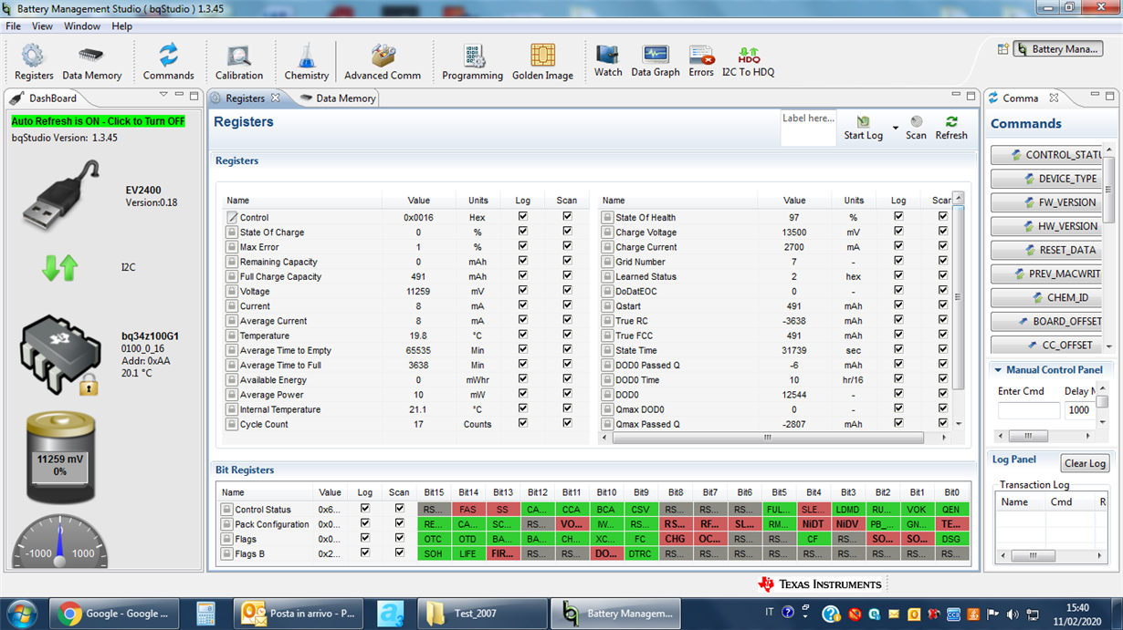

    Here you can find screenshots of the Registers content for 3 packs with the SOC=0 issue:

  • Your screenshots show a more fundamental problem. True FCC is 0 for two screenshots. And DODatEOC is 16384. DODatEOC stands for Depth Of Discharge at End Of Charge and is scaled by 16384. So this means that DOD at charge termination is 16384/16384 = 1 = fully discharged, which doesn't make sense. Hence True FCC is zero and SOC will be zero.
    So something went wrong with end of charge detection. Please check if your system (charger, battery and gauge configuration) allows reliable charge termination detection as described in 3.7, http://www.ti.com/cn/lit/ug/sluubw5/sluubw5.pdf
